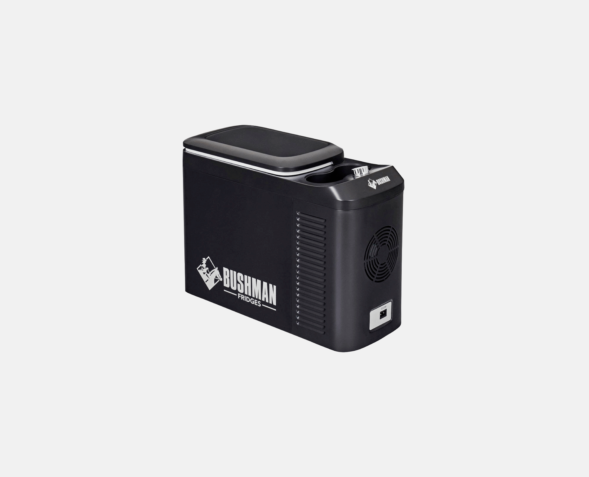

Hi all, been jumping around the forum off and on over the past few months since purchasing a T5
Hi all, been jumping around the forum off and on over the past few months since purchasing a used T5 Beach in Australia and been finding some invaluable advice. One thing I have been looking at particular have been the threads on fridges, especially any that fit between the 2 front seats.
I may have found something here in Aus that others may not be aware of and I am heavily thinking of purchasing. It's a 15L fridge by Bushman that comes in at 22cm wide.
Link below:
Link below:
