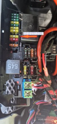

No blue 15A fuses there. Any ideas where I can find else? 2020 T6.1 LHD. Some fuses are there but different ones, a battery and inverter under the seat.

Which fuses are there. There was some mention that on the T6.1 they might be 20 amp..
The actual fuse position and value can vary within the fuse box, but not he fuse box. The Leisure, Non-base vehicle , electric fuses are under the seat.
Issue resolved. 20A fuse found under the driver's seat LHD. fuse_image_2025-07-13_14-12-23-286.jpg
I had to take out the after market swivel seat installed on 4 bolts. Everything took about 40 minutes.
