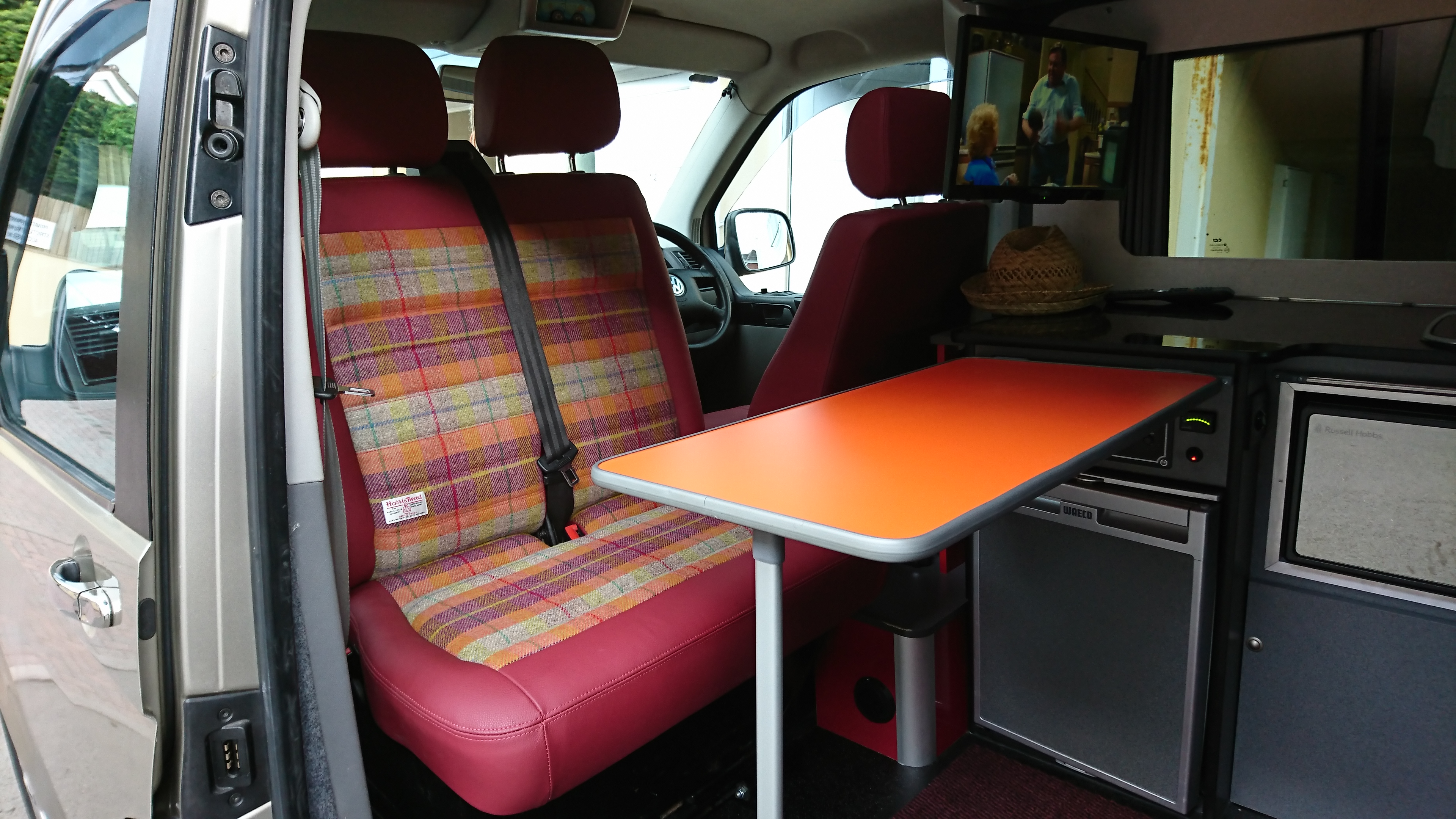

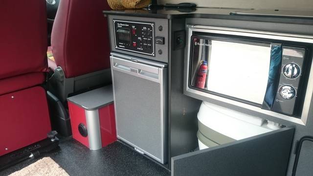

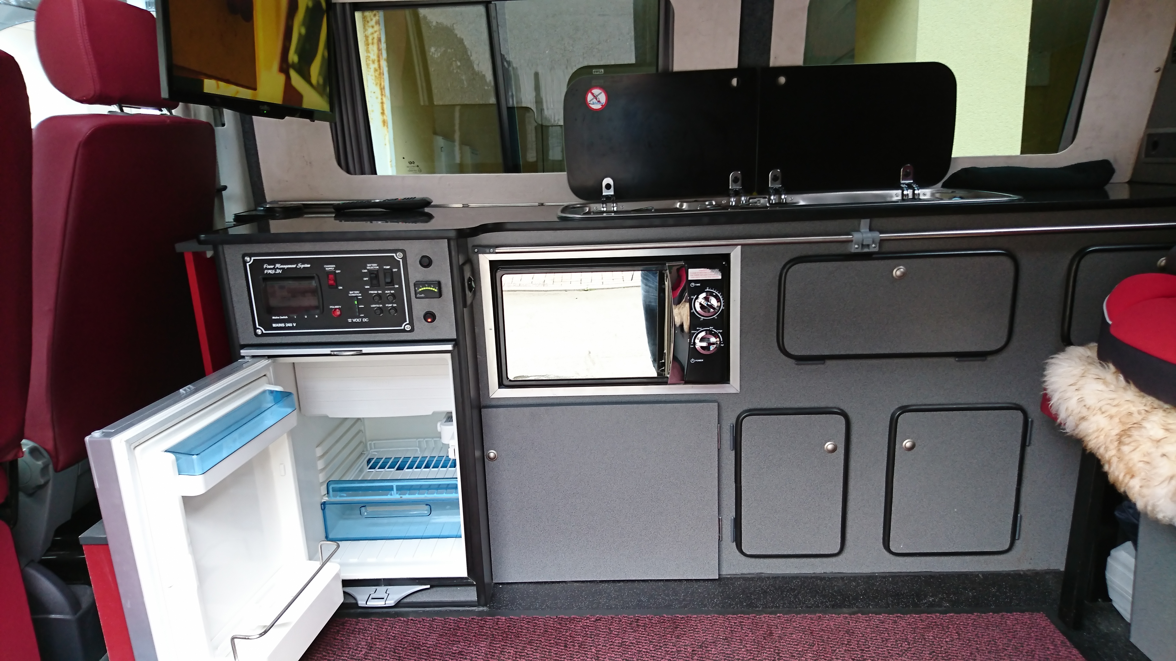

Standard lay out, obviously, door on the other side, kitchen unit with rear wardrobe, Smev 2 burner sink and hob, Waeco CR50 compressor fridge, storage above in roof space, and under the worktop, with microwave, and toilet hidden behind a door.
Fixed 3/4 width rock and roll bed, which can slide forward to lower the back for more comfort, but alas not slide all the way like caravelle etc...
In the bottom of the wardrobe at the rear, there are x2 130aH leisure battery's. At the side at the rear is a shower point with hot water from a Truma TT2 tank holding about 5 litres, which is behind the drivers seat and the Eberspacher runs its heat through here to warm the water. It also has a 240v immersion heater for when it's on hook up.
It has a double swivel seat up front, which also folds flat.
There is a internal rail as part of the roof on the rear above the barn doors, and opposite the roof lockers, the wind out pole and rafter for the Fiamma F45S awning goes up here.

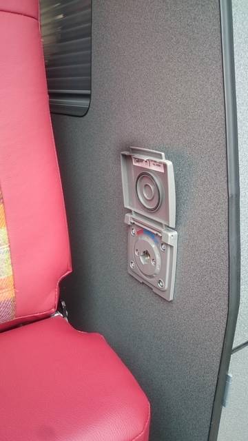

Alongside the area behind the sliding door is a small box for magazines, kids toys etc and the handle to release the bed, there's a large cup holder/wine bottle cubby, and at the end of the box near the door is the external bbq point, feeding the hob also from the underfloor lpg in front of the spare wheel.
Also underneath is the water tank for the sink and hot water, shower which is under the side sill. It still retains all (aside from one) of the factory undertrays.

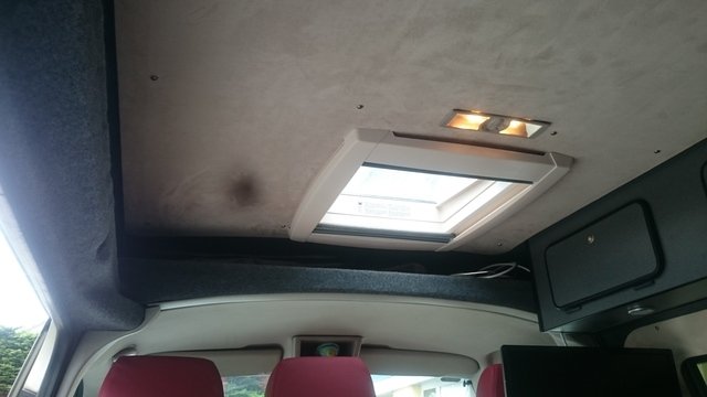

The ceiling has been redone in Alcantara type fabric, with a couple of low warm colour led reading light, with further brighter blue/white leds under the roof lockers.

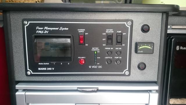

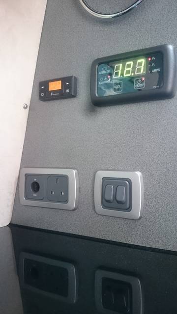

Additionally, I have also had a pair of mini heki style skylights either end of the roof, with a 200w solar panel in the middle. The control electronics are from Ampera Associates and controls the solar system and the dc-dc charging for all batteries.
The other electrics are standard Zig type mains, 12, charging unit with circuit breakers and switches for fridge, pump etc..

The heater unit and control etc is about 80£ or so iirc. I had space behind my drivers seat which is not swivel and the heater hose comes up through the underfloor mounted Eberspacher and comes out under the drivers seat and takes a tight turn into the back of the heater, and then vents from the front of the red box which houses it, next to the fridge on the above picture. The box also has a small shelf and carpeted inner area next to the fridge where the entire TV can be removed if required, and slid into it's hidy hole.
