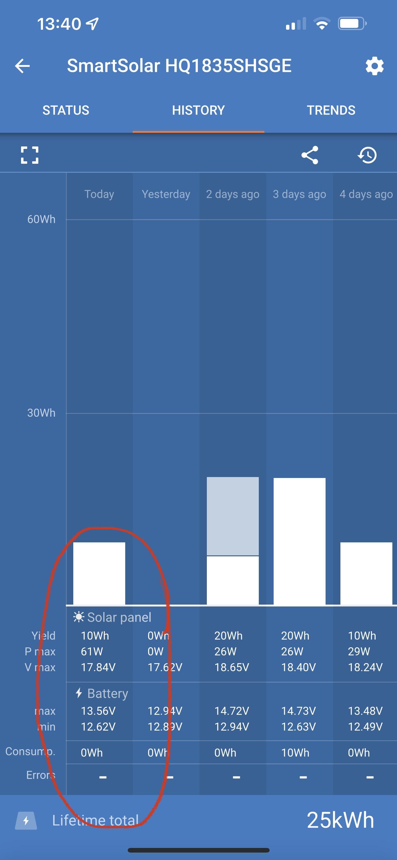

Full sunshine and 9.7v measured at the panel terminals.
Time for a new one?
Tell me what I already know.
Time for a new one?

Then this overcast Sunday morning this happens:
YESTERDAY it registered zero anything when I looked, registered as OFF but battery voltage wasn’t high enough to justify that and given the previous test of 9.x volts at the panel socket in bright sunshine - I’m miffed.
The ONLY thing if done in between then and now was to hook up on drive for 24 Hours and yesterday I popped the panel diode cover off to have a look (but it was filled with white silicone so I put it straight back on)
Confused now.
[edit] the van van hasn’t moved in this observation time & NOTHING is turned ON, so there should be minimal drain.

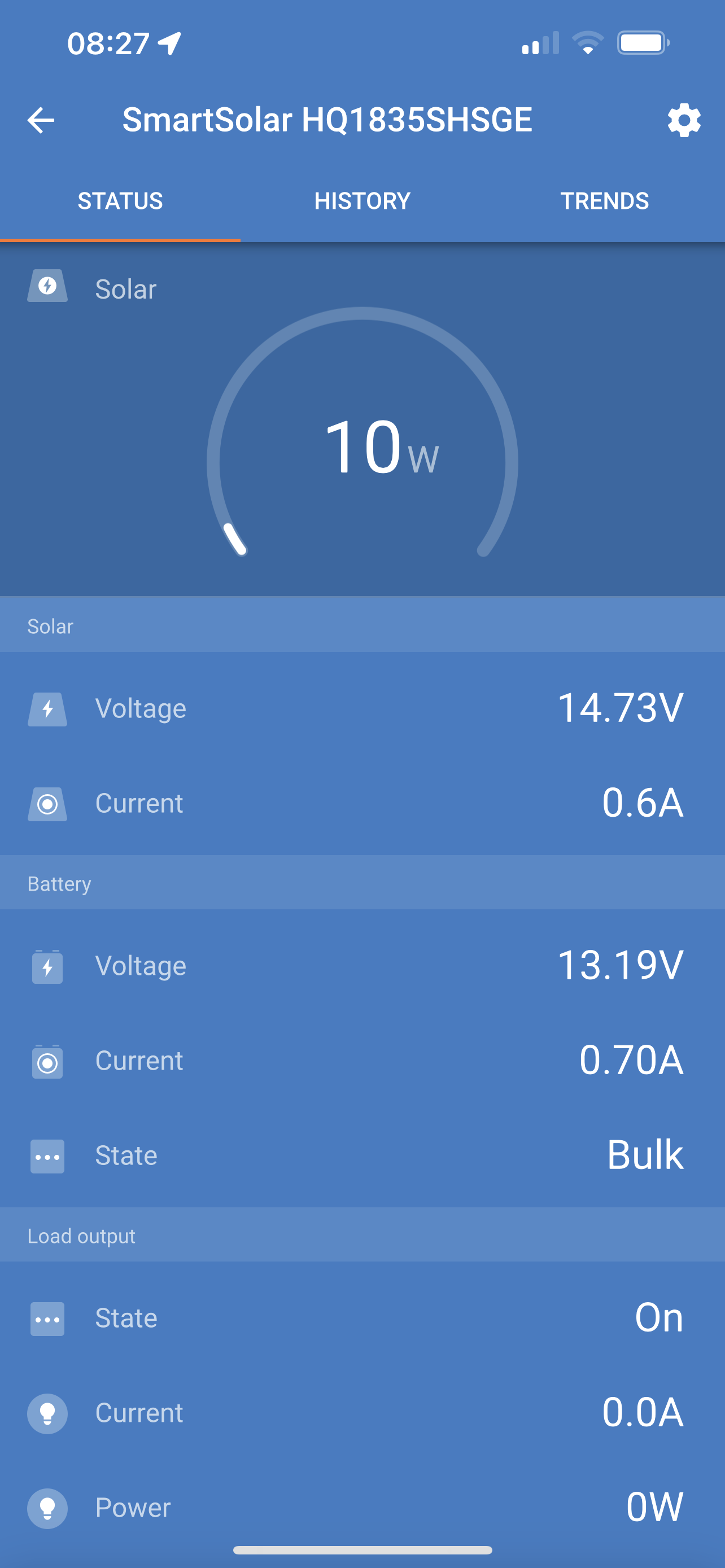

Previously registered BATTERY 12.49v / panel 0 watts/ Charging OFF / direct, bright sun
Today registered BATTERY 13.19v / panel 10 watts/ Charging BULK / overcast
I give up….
