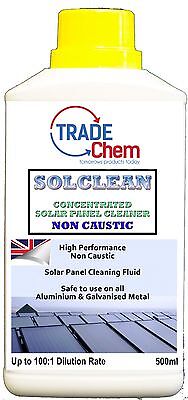

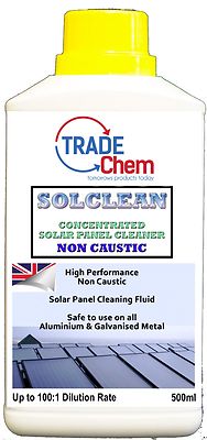

So what’s best...?
Automotive window cleaner should be fine
Autoglym fast glass can be used on perspex / plastic/ glass etc, no residue left behind
So what’s best...?
One possible option
solar power option, might have bridge clearance and carparking problems
