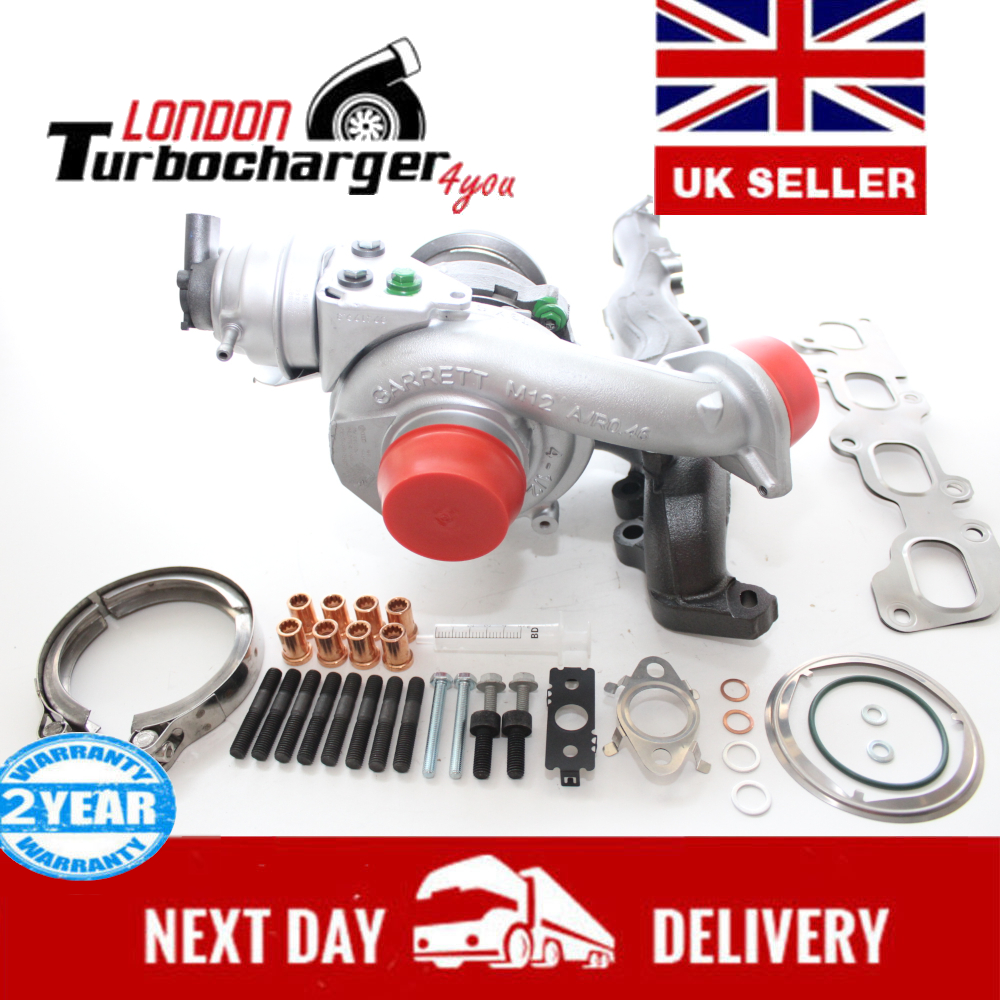

Where do you get your prices from? bare in mind its only a five year old van.£4k to replace a turbo is utter nonsense. Turbo cost approx £600 (exchange so £100 back), 2 hours labour at £50/hr, oil service included.
turbodiesel.cc
Turbo Turbocharger 830323 Garrett VW Transporter T5 T6 MULTIVAN VW CRAFTER MAN TGE 2.0tdi 2.0 TDi 140HP 150HP - CXG, CXH, CXHA, CXFA, DAUA, DAUB, DAUC, DASA, DASB, DASC + Gaskets Brand New
04L253014A, 04L253014C, 04L253014H, 04L253014L, 04L253020G, 830323-0003, 830323-0006, 830323-3, 830323-5003S, 830323-5006S, 830323-6, CAAA, CAAB, CXFA, CXG, CXGA, CXGB, CXH, CXHA, DASA, DASB, DASC, DAUA, DAUB, DAUC, V550 Turbo Turbocharger 830323 Garrett VW Transporter T5 T6 MULTIVAN VW CRAFTER...turbodiesel.cc
A decent reputable indy will fit it. I've literally had it done this week and the turbo was almost twice this price.
Oil has to be changed to cover the warranty. I was charged £30 for oil, £16 for filter and 4 hours labour.
Pay the big bucks if you like.
I don't know what the van spec is, just a quick search.Are you going to put a link to a Biturbo one rather than the simple cheap single turbo for a 150?
