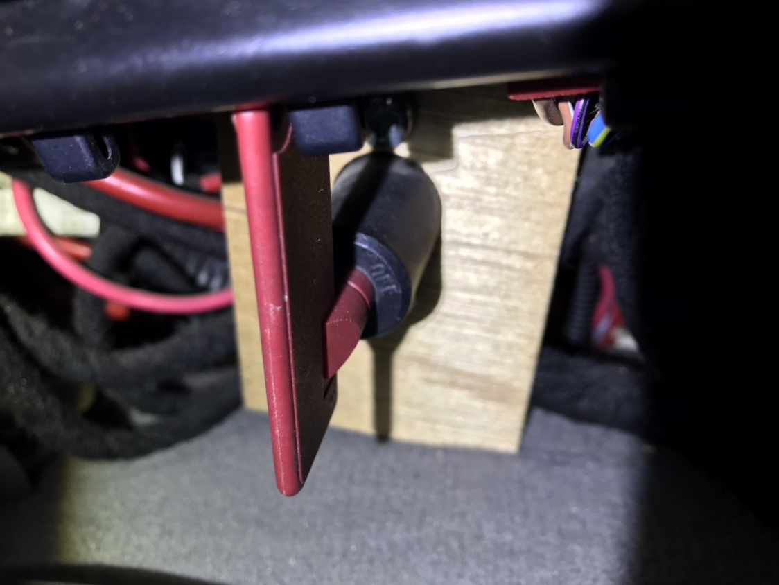

Found this red switch underneath my driver seat a while ago, forgot to ask so I try here: Is this aftermarket from a preowner and is it to cut the leisure batteries off (for example in winter)? Thanks for any hints and help!
That looks like a battery isolator to me.
Yes, looks like an isolator switch. I fitted one on my old T25 so I could disconnect the starter battery, for 2 reasons: 1. to reduce the risk of the ban being stolen, 2. to reduce the liklihood of battery drain when parked up or camping for a few days. If its like mine, you twist the red plastic key anti-clockwise and remove the key.
Thank you PeterE! Never used it so far but def a great feature!
I suppose you need to check which battery it disables - the starter or leisure. On the T25, I had to get a bit of re-wiring done so that the radio, cabin lights and cigarette charger would run off the leisure battery instead of the starter, and so I could use them while camping and starter disconneted. In old vehicles, its not unusual to get battery drain due to some minor short circuit or warning light that stays on somewhere.
Thanks again! I am going to check with my local garage. My guess: it disconnect the leisure batteries.
