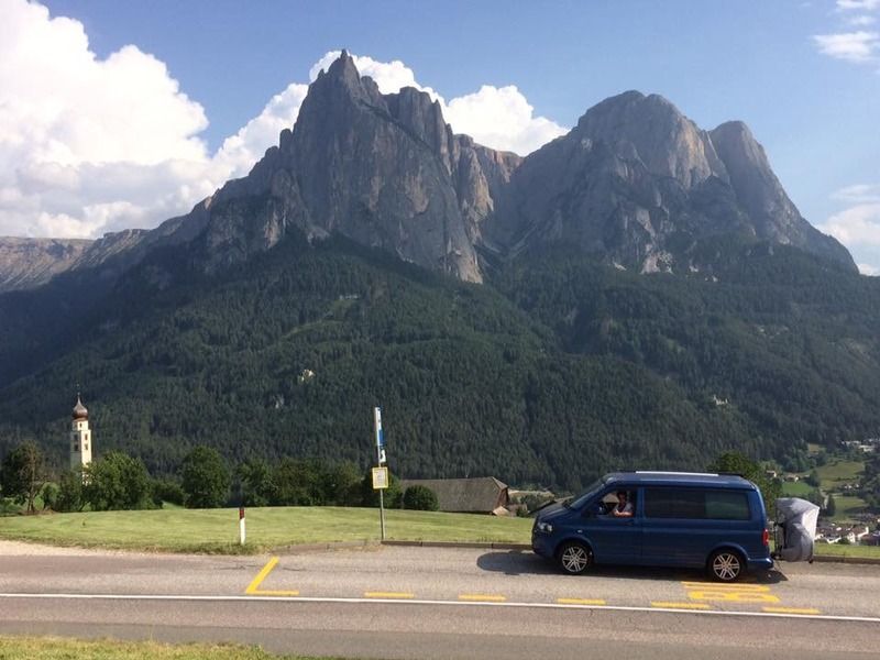

What type of rack is that on the picture? Looks really good, access to the back, but also the bikes aren't super high.
Hey Brent, looks to me like Atera Della Strada.
http://www.atera.de/en/atera-strada-dl.html
I got it myself as well and it works great, no problem to open the tailgate. When not used folds nicely and fits the space under the bed. The only problem is reversing as the sensors go crazy and make a lot of noise :/ I am now considering changing for the original but that means I might not fit the "up to 2m height" carparks. It's not easy!
Hi
Yes it's the Atera Strada dl3 rack.
I can't recommend it enough. Superb build quality, probably the best I've come across. The rear parking sensors disable when connected, but you get a sign on the dash with a trailer to remind you the rack is there when you select reverse.
I used to own the Volkswagen tailgate rack, but got rid of it. As it limits access into the rear of the vehicle, because you can't lift the rack with the bikes attached. It is possible to lift, but you need to be very strong, plus it will leave dents where the rack attaches to the top of the tailgate. Trust me, been there got the T-shirt.
Another plus point is, you can remove the rack from the van within about 10-15 seconds.
Without doubt hands down, one of the best things we have bought for the van
