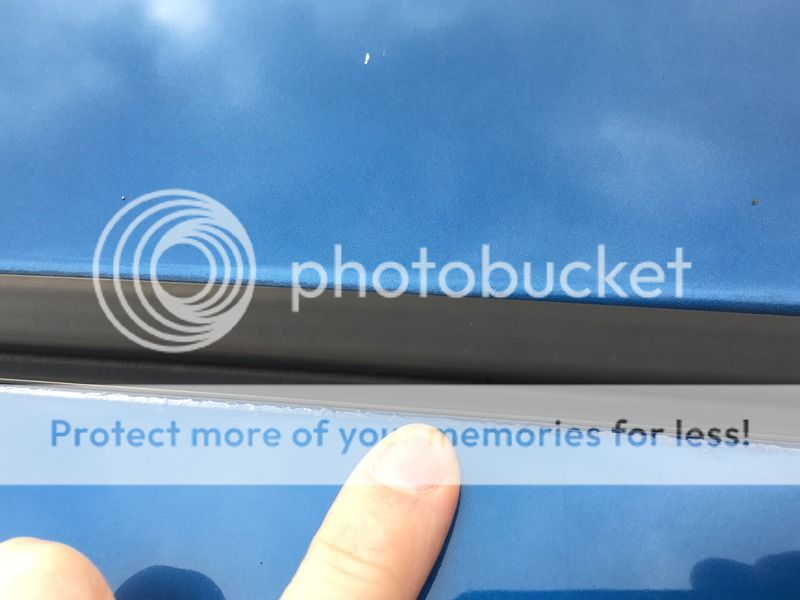

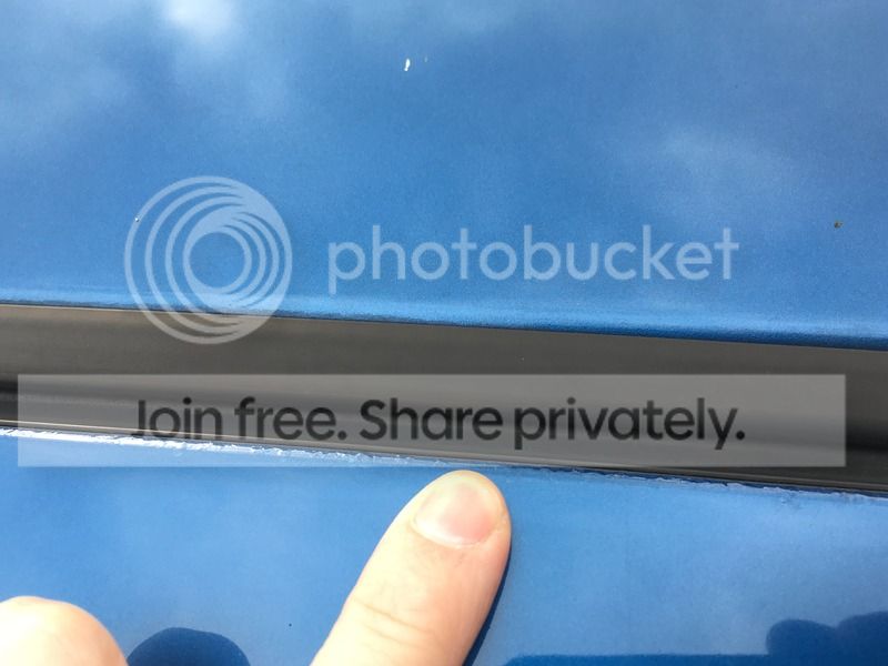

That's the front spoiler where the poptop meets. The black rubber is the part attached to the poptop roof.
Not the best pic :talktothehand

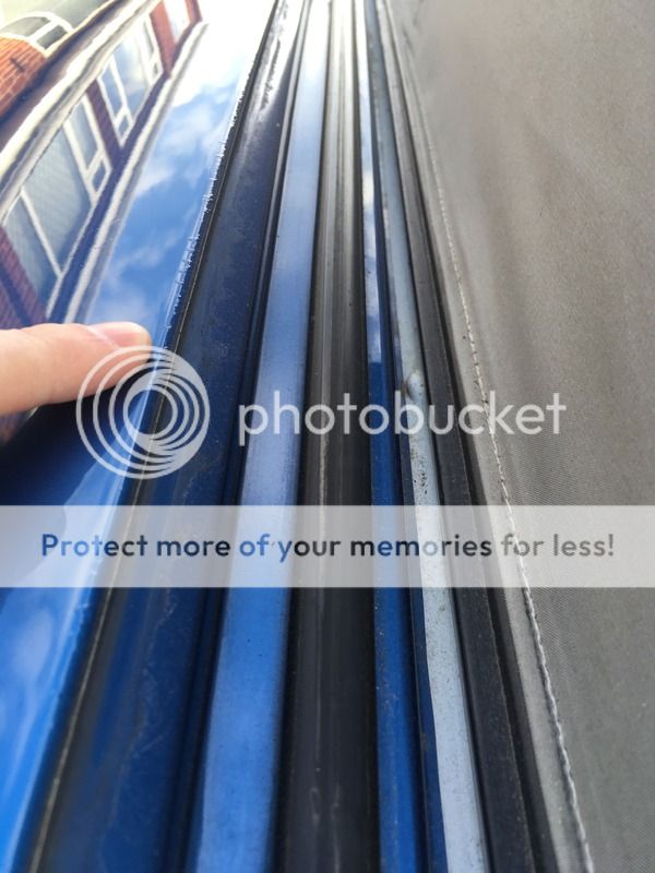

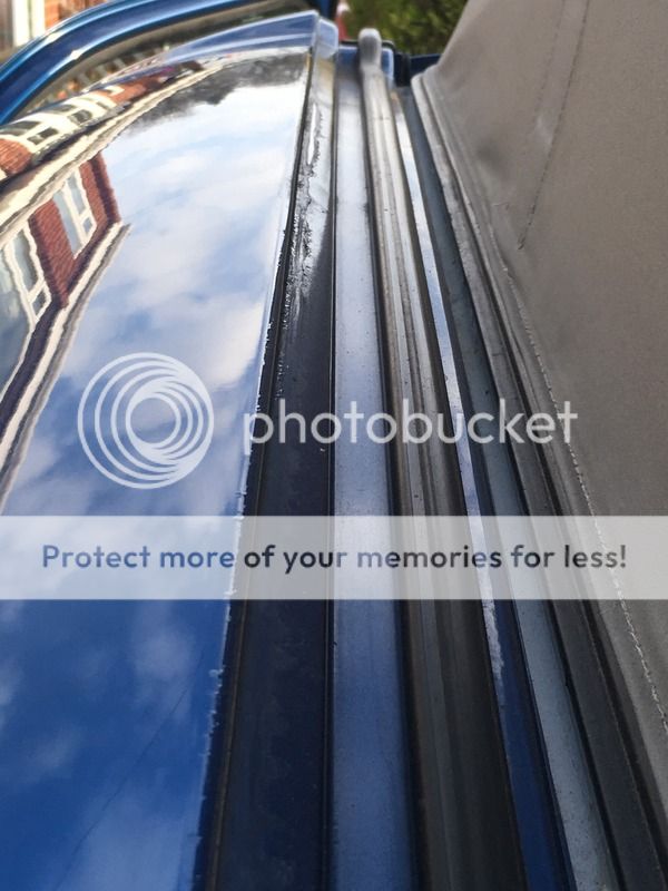

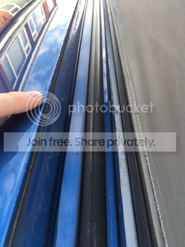

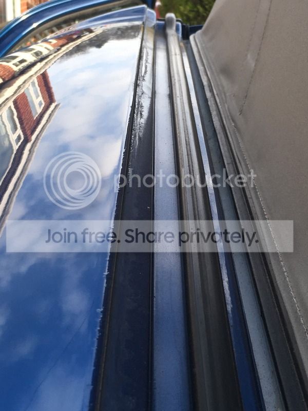

Im going to pop the roof tomorrow and have a proper look
What does it look like with the roof raised?
Have you had a look underneath the seal on the side of the raising section of the roof?
What year is your Cali?
Not yet, but will definitely take a closer look tomorrow.
2012, so its bang smack in the mix of it all.
Grrr
