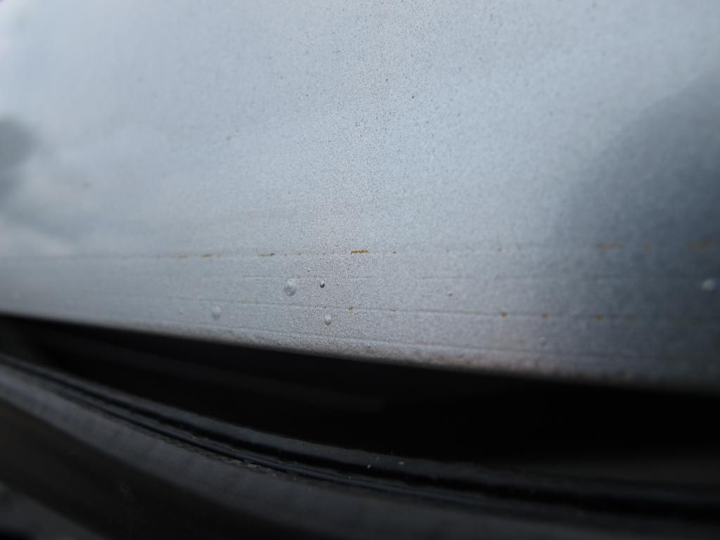

This is the bubbling under the seal on my 6 month old Cali SE
To find this, raise the roof slightly, stand on the drivers or passenger step pull down the seal and take a look.

Dont forget it spreads upwards so might be worth looking sooner rather than later, it will also be helpful to the forum

It is important to check both sides.
Mine was only bubbling down one side.
