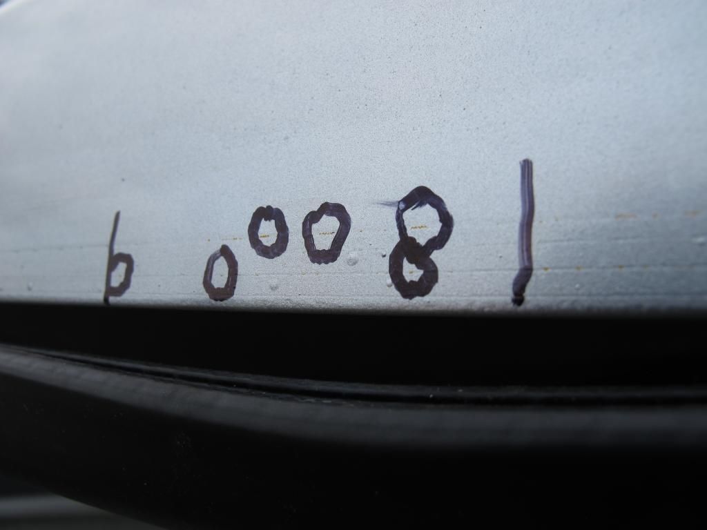

Mountainman - I was able to detect minute bubbling along the edge of the main roof panel where the rubber strip meets it (if that makes sense). Like you I didn't want to lift the strip. Hadwins, my local VW dealer took photos and my claim has been accepted. I must admit I was pleasantly surprised as the bubbling was barely visible in the photo. Good luck! Ian

This is a picture of the bubbling under the seal of my Jan 2014 Cali SE, taken when it was 6 months old.
The horizontal lines are where the seal grips with the steel "claws" and you can clearly see brown/red stains from the rust in the black circles. This is not where the bubbling is.
The bubbling has taken place where the water was trapped in the seal. I suspect "pin holes".
So to my mind the paint shop owner is correct in saying "it is not bimettalic corrosion but water against paint"

Exactly steel , water, pinhole, aluminium = Bimetallic Corrosion.
Remove water, or improve paint/primer insulation.
Or are you telling me there are NO pinholes in the paint over the rest of the Aluminium roof panel only in this one area or that the roof never gets wet.
I would suggest you had the problem one side only because water got behind the seal, whereas the other side didn't developer anything because there was no water ingress.
You could be right about the paint shop owner.
There will be pinholes all over the paint but they are not submerged in water 24/7 365, this in my opinion is what causes the paint to bubble. The photo shows the steel rust well away from the bubbles
Exactly metal - electrolyte - metal. They don't have to be in physical contact just electrical contact to make a circuit.
