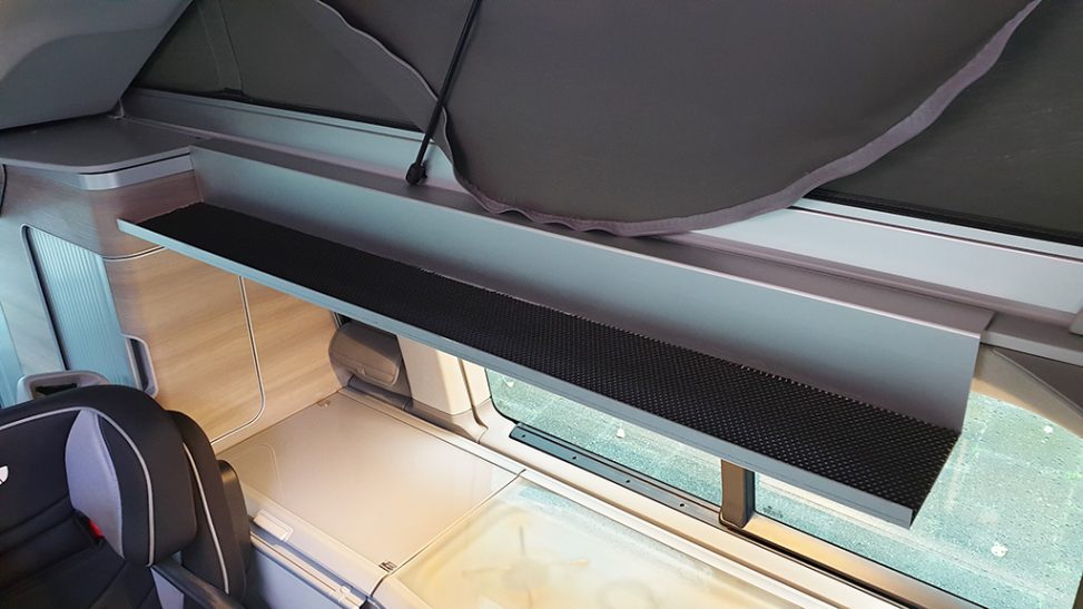

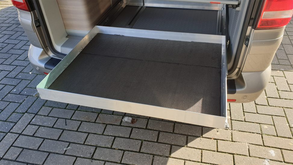

Not so much bought, as made. I followed in many owners' footsteps and build both a slide-out for the back of the van and a shelf for over the kitchen. Never worked with metal (aluminium) before, but am happy with the results.
That looks fab ThomasHJ
Are the guides screwed to the floor?
Did you purchase the guides and rollers, or make it all yourself?
I build a frame out of aluminium L-shaped profiles. Same for the drawer. Bought the guides that connect the drawer to the frame and makes it slide open.
Love your shelf I see that being very useful when juggling things when cooking.
How is it fixed? Do you remove it when moving location? It looks like it could stay there when the roofs down.

Yeah it stays in place always. When the roof is down the bed locks it in place, but its stuck on there with two strips of Tesa powerbond Ultra strong. One strip should supposedly be able to hold 10KG per 10cm of tape. They say a maximum of 6KG per object. I used 2 strips just to be sure and it seems very solid.
