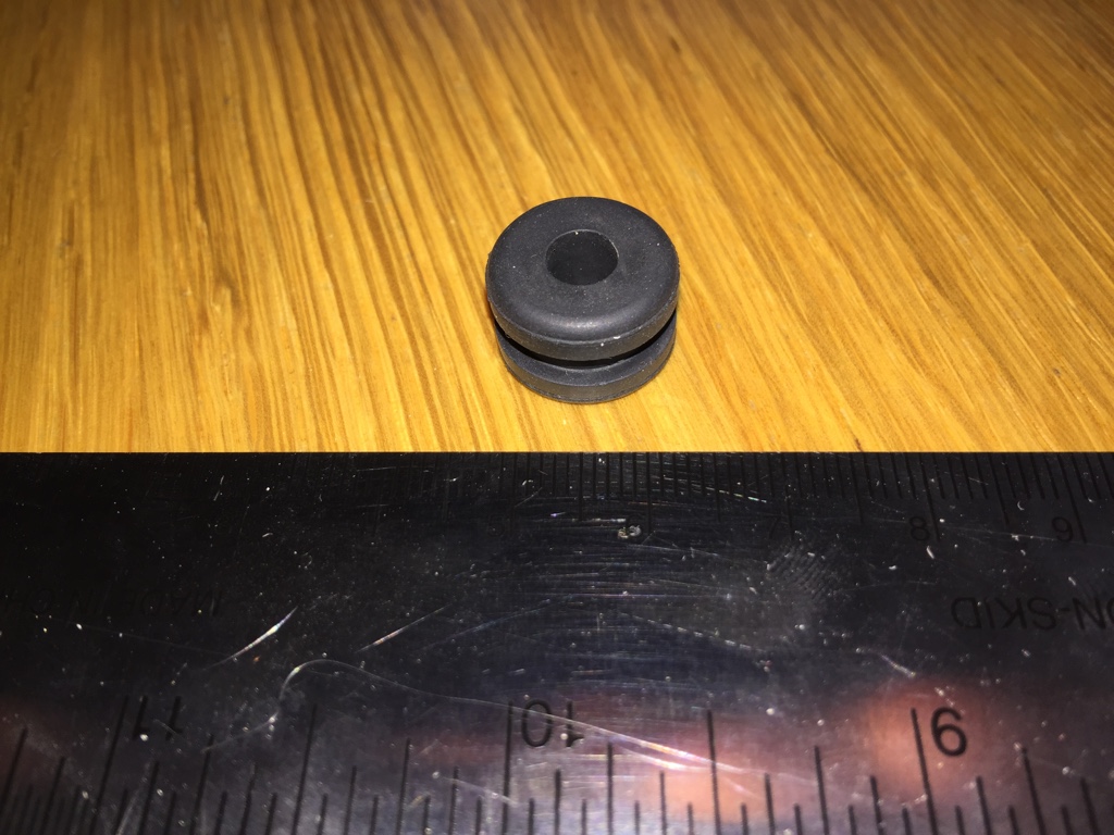

My door blind trim was out of line and came off the day after I bought my T6. Took it to Breeze Poole who said it is a common problem caused by adding an extra grommet by mistake during production. They removed the grommet and glued it. Now lined up and working correctly.
Must be costing VW a fortune in grommets, everybodys door blind is out of line. :)
Where's the grommet?
IIRC the trim surrounding the sliding door all came off. The grommet is a 1cm black rubber washer that must be used as a spacer.

The offending item causing door blind trim problem
