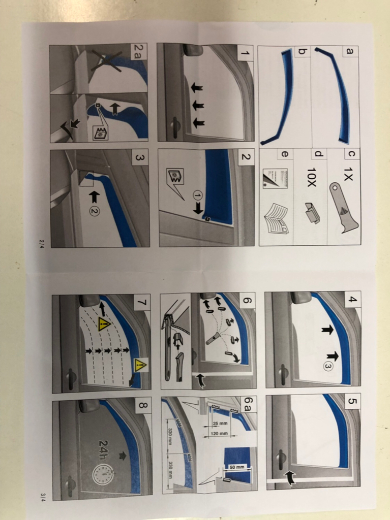

Latest and greatest, non stick on version from VW, but I haven't been able to view the install instructions, so I wondered if anybody here had fitted these themselves? 7E0072193 HU3
Yes. Team Heko used them for years. Easy fit no wind noise. Stops the drips when your parked up, it’s raining and you have window open for ventilation.
Fitted with care, but easily... here are the instructions for anybody that might be interested....
