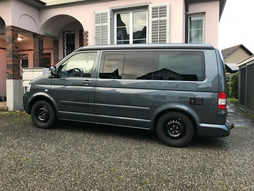

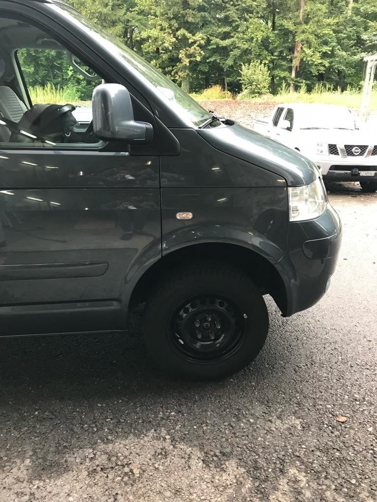

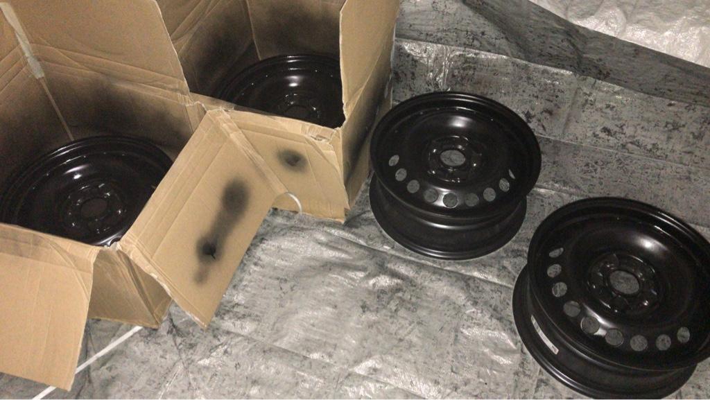

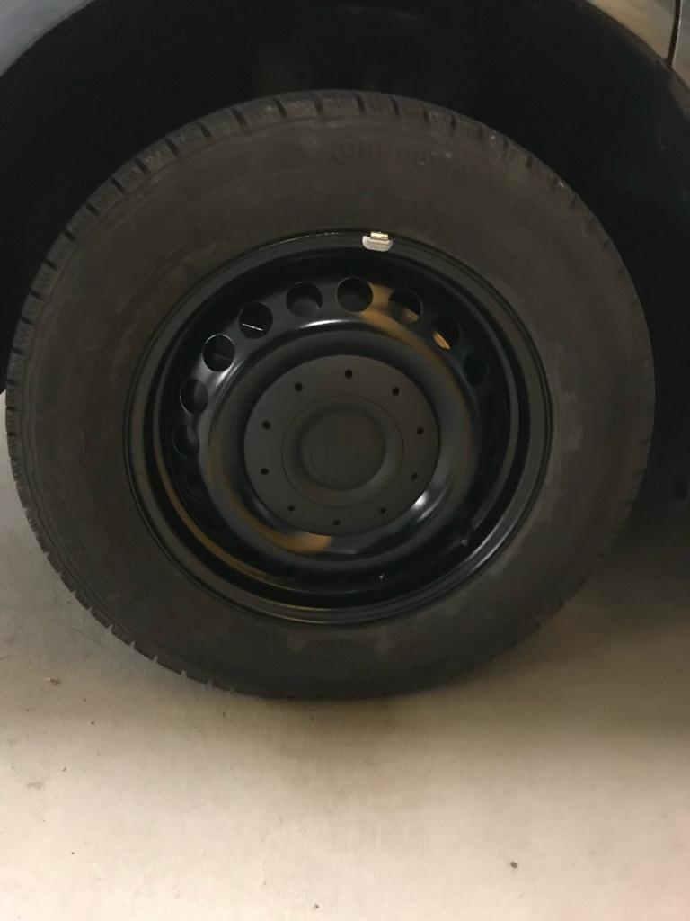

The black steel rims look good. Did you just spray them yourself?
