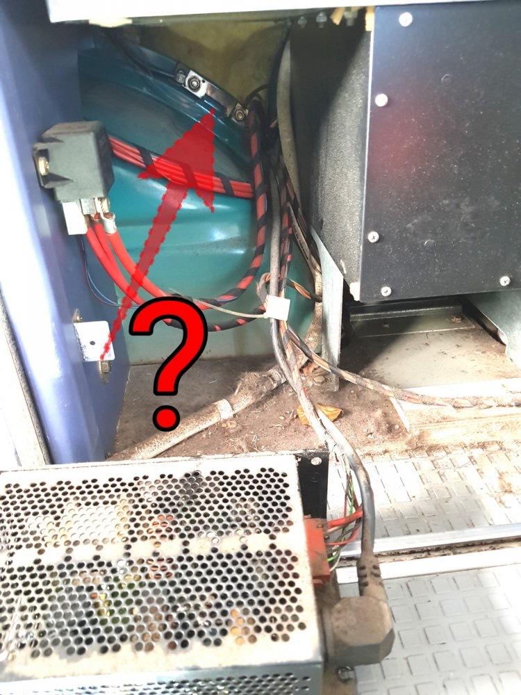

Guess I'll have to measure voltages trough out the connections and check for faults, routing under fridge seems like a standard faulty area?

A bit of reading around suggests it might be worth checking the condition of your earth shunt. I believe this can effect the readout if it’s in poor condition.
