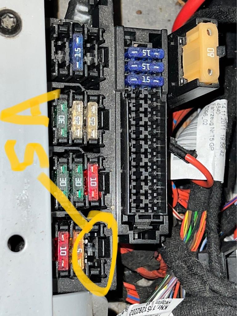

I think your best bet is to switch off the Control Panel. You say you cannot do that, so you could either remove the fuses for the Control Panel or remove and disconnect the Control panel to allow it to reboot.
T5 fuses. Position of fuse in the relevant fuse box may vary, but the fuse value and which fuse box will be accurate.
Fuse should be under passenger seat it’s a 5 amp one.

Quick update folks. Thanks for all your ideas. I removed the panel and pulled out the power which reset it, but after reconnecting and turning on the ignition, the fault immediately returned. So I guess the sensors have a legit issue and I’ll need to get this looked at.
In the meantime, I’ve pulled out the fuse so it stops the audible alarm. It rings out about 8 chimes, and that happens every time you drive off from a standing position i.e at every set of traffic lights you go through. It was driving me crazy.
Incidentally, my fuse layout was quite different to the layout you supplied [mention]WelshGas [/mention] … I ended up pulling both 5 amp fuses out until I found the right one. It was under the seat in position shown in picture.
