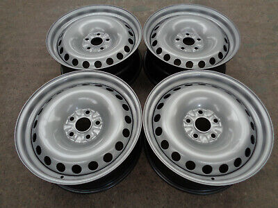

We specced the Cali with 17” Woodstock’s and All Weather tyres. Happy with that for 90% of our intended usage, however we intend to do an annual trip to Switzerland and possibly Norway, so I’d like to get hold of some Steels and proper winter tyres for those trips. I don’t want to ruin the Woodstock’s using snow chains, which i’ll need where I’m going. I’ll just store the Steels in the shed when not in use.

Where is the best place to source the steels? How much do VW charge?
I’ve seen someone called Benni mentioned on here but I can’t find any info on him. I looked on eBay but what I think is possibly his eBay shop, is only showing 16” steels for T5/T6’s?

You can pick up 17 in steels off ebay in the range of £150, but they may need a bit of cleaning etc. Get a set and get them powder coated for longevity. Just ensure that the rims are ET56 and Correctly load rated for a Cali at 950 KG per wheel (see pics).
Tyres - there are many options, again ensure that they are at least 102/3 load rated and have the mountain and snowflake symbol for your intended use.

Be careful with the sizing as well as the loading if you're thinking of fitting chains. The standrad size "normal" Cali tyres won't take chains. For info we had 225x60x17 on ours and chains fitted fine.

I bought some alcar 9215 17" steels for this winter which seem to be pretty ubiquitous online. They are pretty close to the brake caliper on the front, but I guess that's normal. About 5mm clearance.

All 17" are close to the big disc brake callipers which is why 16" can't be fitted.
