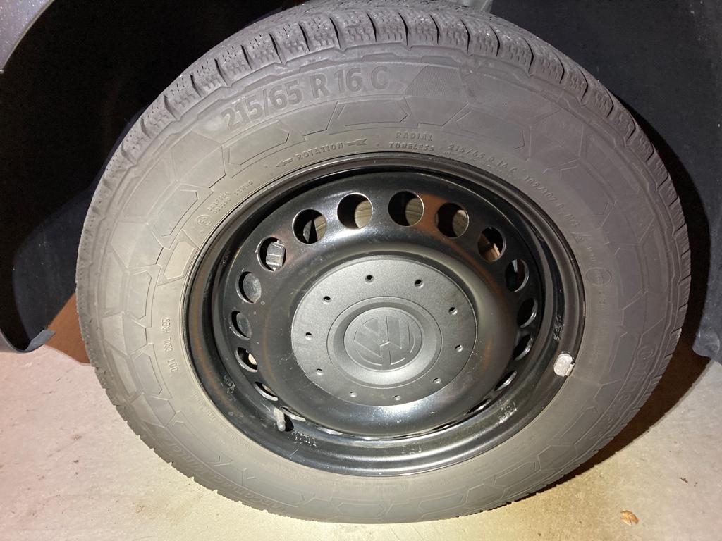

17” Steels & tyres just for Alps trips
We got 16" steel wheels on a T5 and some Conti Winter Tyres and some chains from the local store (Migros). Used them quite a lot to get up to the resort in Flumserberg (Police sometimes check).
Had a pair of Snow Socks for emergencies but never needed them.
The Snowflake symbol on the All Season tyres is all you need to satisfy the authorities that they are fit for purpose. Certainly the case in Germany, Austria and Italy where we traveled.
Im very wary of snowsocks especially on the van with it's heavy weight. Our avatar is the van outside our place in the Pyrenees a few years ago. When the road eventually opened the police were taking convoys down to the valley if you had chains or snow socks. The car park in the valley was full of people who had used snow socks and they had nearly all disintegrated and wrapped round suspension and driveshafts. The problem is that they are fine on snow but as soon as you get a bit of tarmac they get shredded. I you can take them off immediatley they are ok but in this instance the police didn't allow any stopping to avoid holding up the convoy.

For what it's worth, I run 215/60 R17 summer tyres and found the ride pretty hard. These are the standard Contivan tyres. They are hard as 215/60 need 3.8 bar of pressure min.
I've recently bought a set of 235/55 R17 wintertyres on Ronalr56 alus (3.0 bars). The ride is almost night and day, much more comfortable now.
If you are planning to run steelies with 215 winter tyres, be aware you might experience a much harder ride that you are used to. With the original VW steelies you can only mount 215 tyres if you want to use snow chains, so be aware you may not like the harshness...
Great point. When we hired a 6.1 it had 215 tyres and they made the ride quite harsh, much like runflats do to BMW’s. At this moment in time I think I’m going to stick to the Woodstock’s + 235 all weather tyres and see how it goes.
