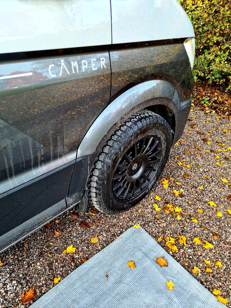

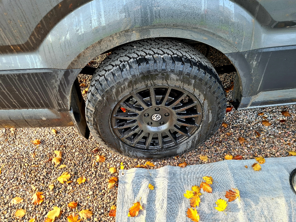

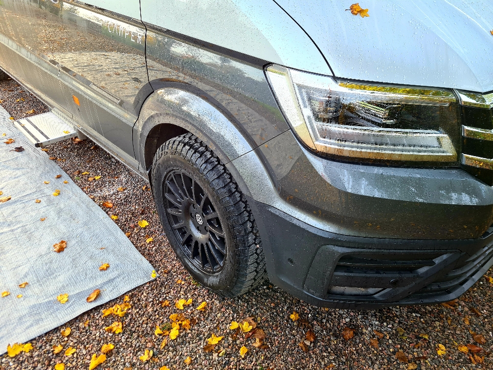

As mentioned above below are the additional and closeup pictures of our new wheels:

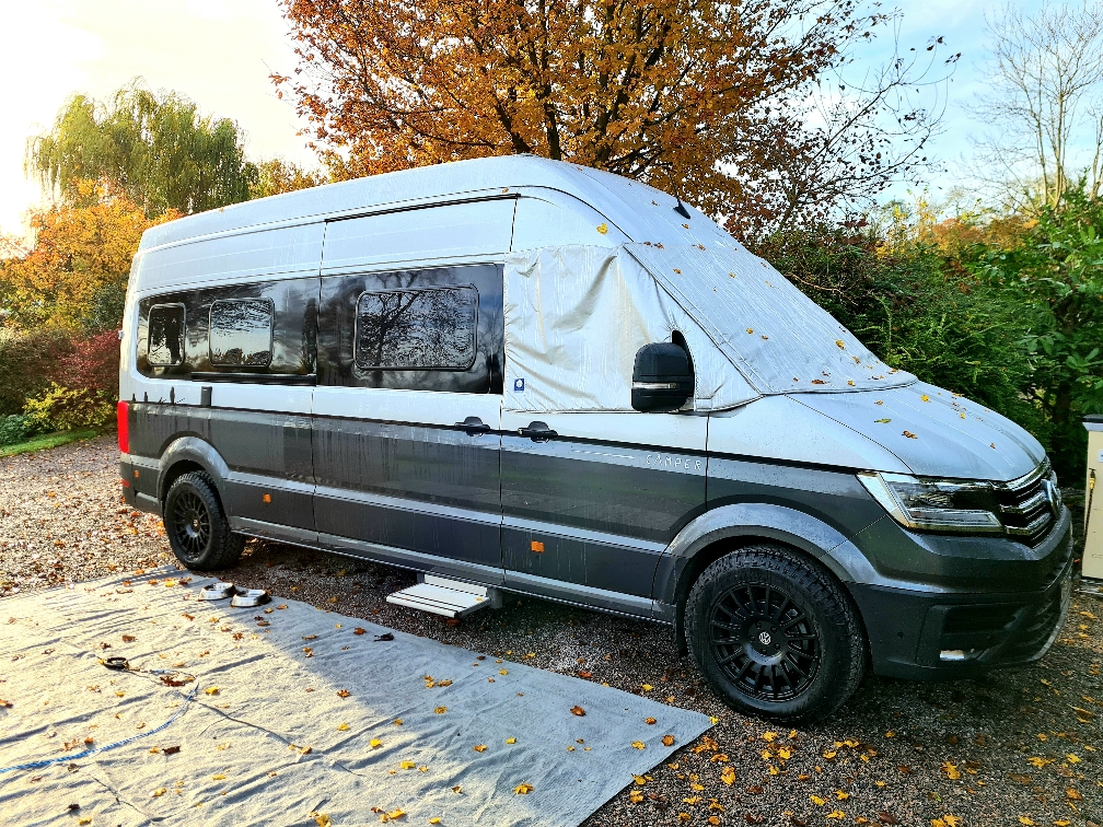

Greetings all to yet another day of government lies and broken promises - but I digress -my wheels and tyres have been swapped out with 16" wheels and 115 rated General Grabber At3's.
Pic's below - and I think they look great
