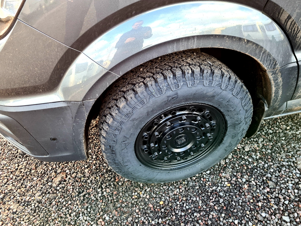

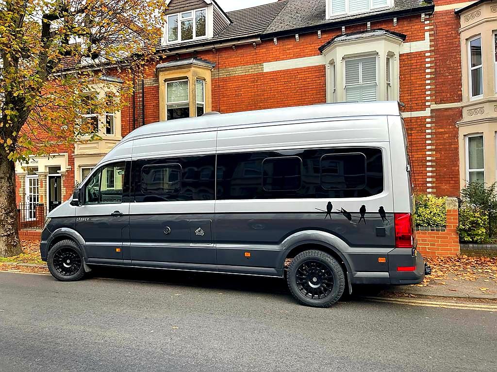

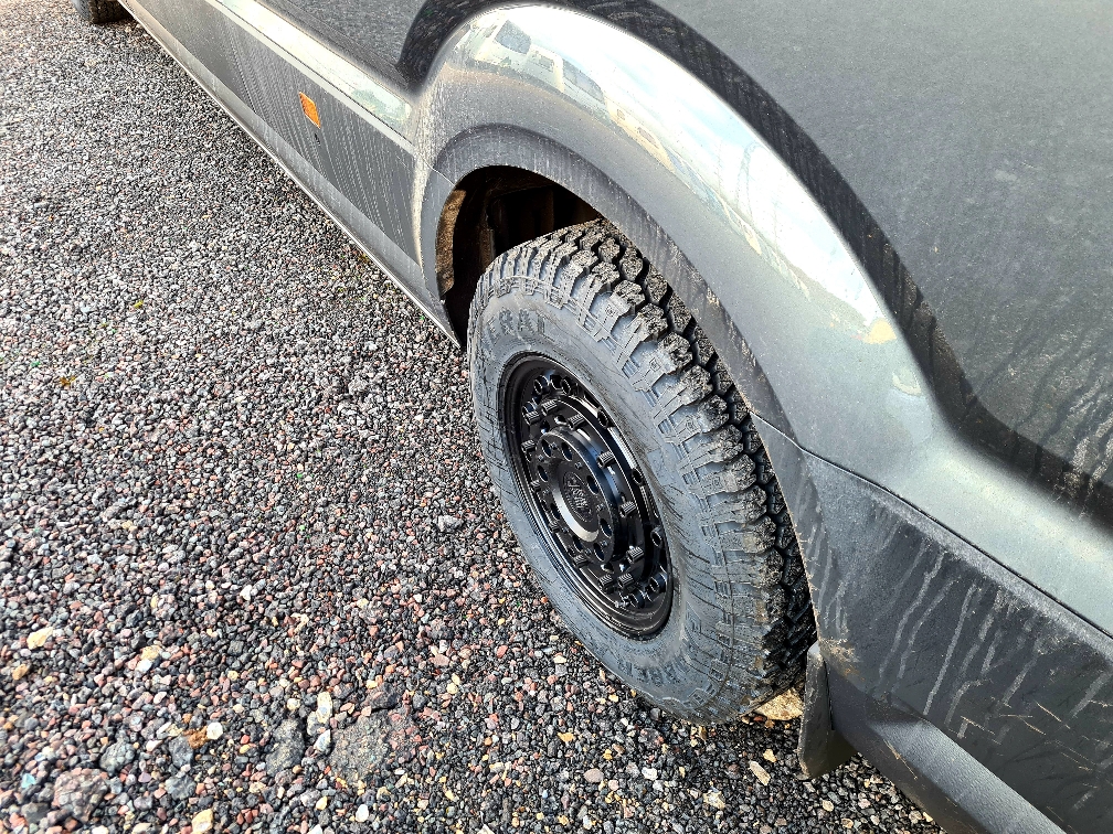

After much changing of mind I've finally sorted the new wheels and tyres for our van. I had 2 main reasons for wanting to change:
1. (In my opinion) the proportions of the standard van look all wrong as the wheels look so tiny in comparison to the huge van body. A bit like a body builder with really skinny legs.. I kept trying to convince myself that I would eventually get used to the look, and honesty I tried, but in the end I'm afraid I failed and the bodybuilder has been forced onto the squat machine.
2. Winter grip. Damn these vans are big and heavy and I kept seeing us ploughing through a hedge on a frosty morning and as we intend to use the van throughout the winter winter tyres were definitely on the shopping list.
I tried using Google to figure out what the best solution was but I got lots of conflicting information and opinions so hence the multiple changes of mind
So in the end I spoke to the good people at Rogue Alloy Wheels and they set my mind at rest and supplied and fitted what I hope is the perfect solution. The wheels are their own brand 18 inchers and the tyres are General Grabber At3's.
So far so good - the ride is slightly firmer (in a good way) and the van has lost a lot of that "soggy" feeling through corners and the steering feels slightly more direct. I didn't notice any increase in road noise and now the speedo reads the same as the GPS. No frost or snow yet so I can't comment on the grip.
Overall very happy with the "upgrade" and they didn't break the bank either.
Sorry I only took one quick snap of them - see below but if anyone wants any closeups I can post them next week. Please let me know.
BTW if there are any traffic wardens amongst you I apologise profusely as I'm parked on the double yellows opposite our house in the picture

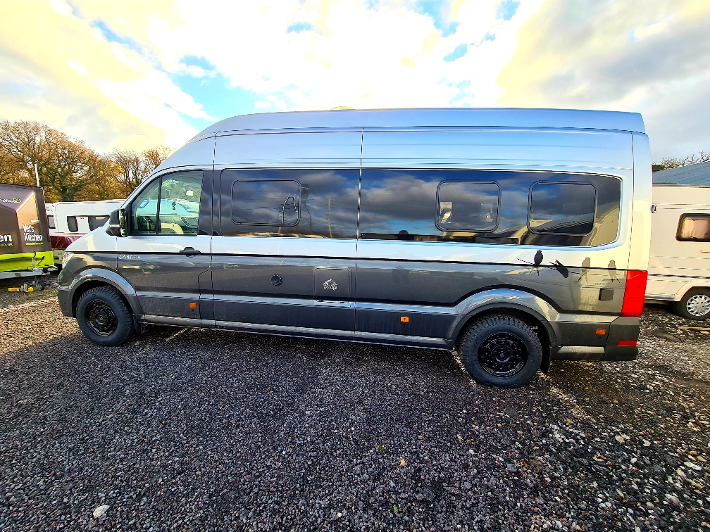

Greetings all to yet another day of government lies and broken promises - but I digress -my wheels and tyres have been swapped out with 16" wheels and 115 rated General Grabber At3's.
Pic's below - and I think they look great
A big thank you to Rogue Alloy Wheels for sorting this out without any quibbles!

Hi ...trying to sort order for this wheel tyre combo from rogue alloys... Do you remember the exact alloy....looks like the 16inch CC1 from their website....correct?

Mpill990...had exactly the same fitted to my 680 today. Driving the 70 miles back home, on motorway, A and B roads I can honestly say that I felt no excess rumble from the AT tyres. Infact they felt just as smooth as the contivans fitted by VW factory. Im hoping the difference will become apparent on a soggy grass campsite! By the way any one want to buy a set of 4000 mile lissmore VW alloys shod with contivans?

Pictures would be nice to see! Glad to hear they don’t add anything noticeable in the way of road noise. New wheels definitely on my to do list once my GC arrives.

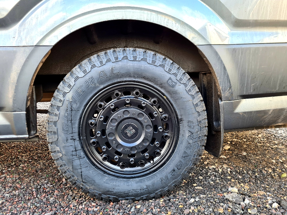

Overall really pleased with the wheels tyre's and as you say no noticeable increase in road noise.
I haven't tried them across a muddy field yet but I would expect them to offer a bit more grip than the standard tyre's but how much more is hard to say as these vans are pretty damn heavy so the weight is not going to help as you are going to sink

I’ve had BFGs on my last joker, great for off road/snow was good too, not getting punchers (side walls super strong), plus tread wear was very good.
I would say that that they are a lot noisier on motorways, make the turning heavier and mpg isn’t great. Again high vehicles will never be that quiet and the noise from BFG was fine for me too (but the noise rating doesn’t lie).
They look great though.
Still tempted by them, will see how the Michelin latitude m/s perform on my new van.
According to the people at Rogue Alloy 's the BFG's are not very good in the wet. That's why I went for the General Grabber's and they seem fine on wet roads..

Didn’t find any issues with them, no spin up or skidding under hard braking in the wet. Not rated good wet though.
