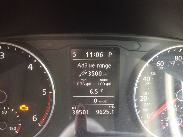

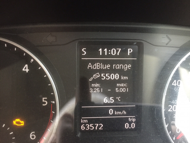

Hi you can change your dash to liters to convert it go to settings- units change it to liters/km and it will give you the info. Also if the pump clicks out then the tank will be over full unfortunately.

The MFD is very precise about how much to refill with AdBlue. There is not really an excuse to overfill.

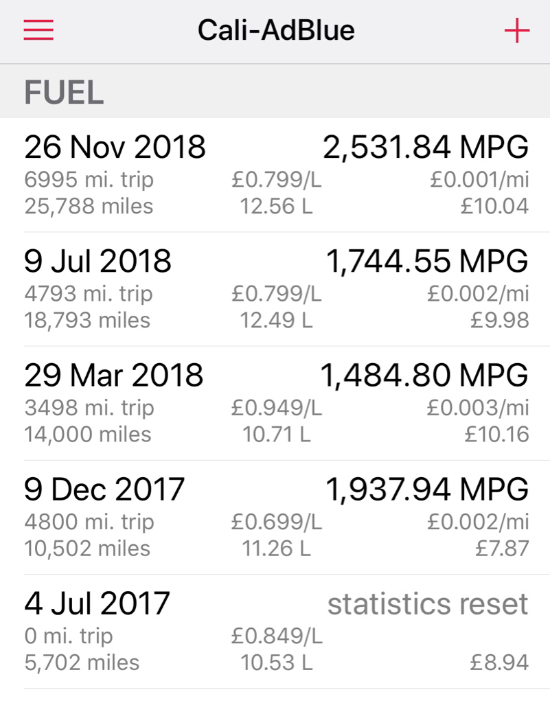

I get over 2000 miles per gallon, so 600 miles range would be ~1.35 litres. Add 12.5 litres and you have 13.85 litres in a tank which should have no more than 13 litres.
I can’t say if this would be a problem or not. If overfilling is an issue I would hope the safe level of filling is somewhat higher than the recommended maximum.
Unfortunately it’s not 13 liters is the maximum hence it’s always advisable to fill up 1/2 a liter less than the maximum advised on the dash to allow for deviations in pump quantity.

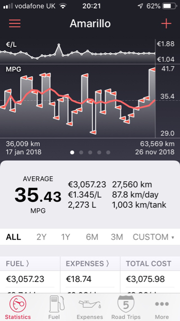

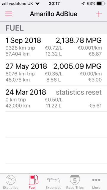

I use Road Trip.
I use it to record all my diesel and AdBlue consumption. I reckon that if ever there is a problem with my engine, increased fuel consumption could be a first indicator.
Is it for iPhone only? Can't find it in Android apps...
Try searching road trip mpg in the play store. According to a quick google search it’s available on both platforms
Thanks, maybe it is restricted to UK store, I don't see it in Belgium... But I found some similar ones!
