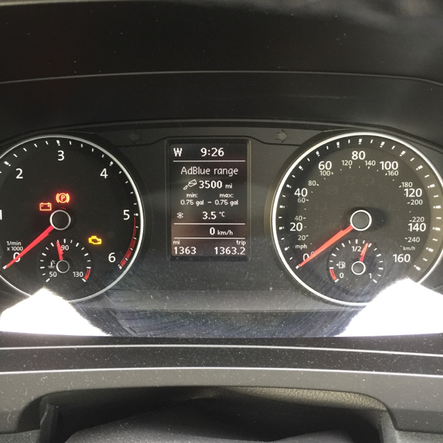

4500 miles which is displayed on the MFD and seems to drop in 500 mile increments.
It also tells you what the max and min you can fill it up, although both reading the same at the mo, will see if these alter with use.
Not sure I have 3500 left so haven't given it much though until this post.
It stops working and has to be taken to a garage to have its software reset and a refill. But it does put at least 2 warnings up before this happens according to the dealer. Pic of warning light info.

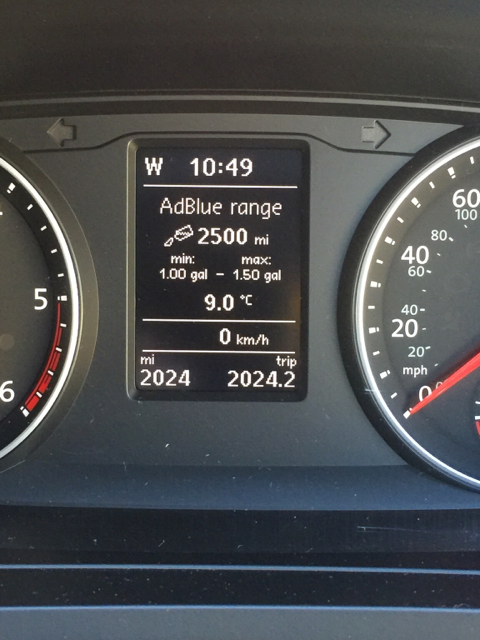

The min and max figures do alter with use. Thought they would but you never know.
