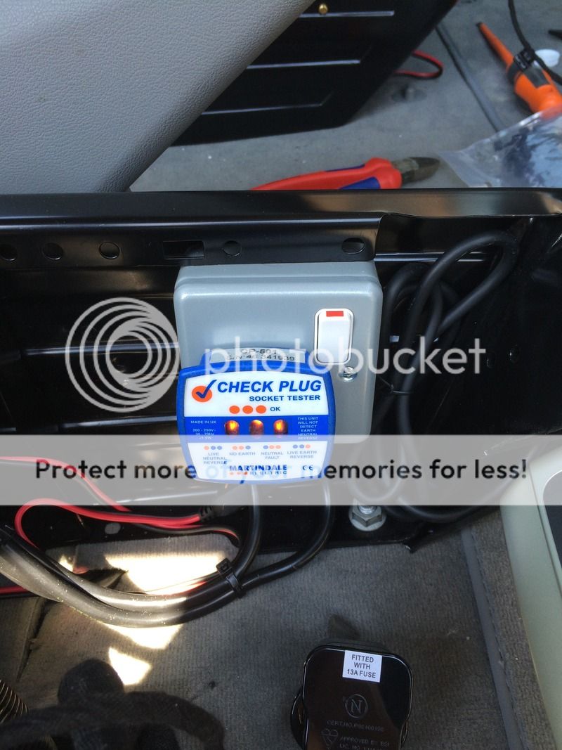

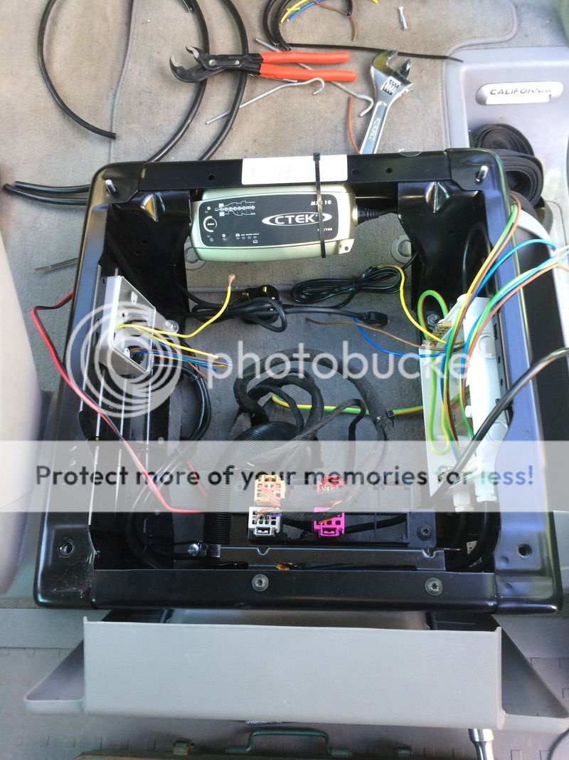

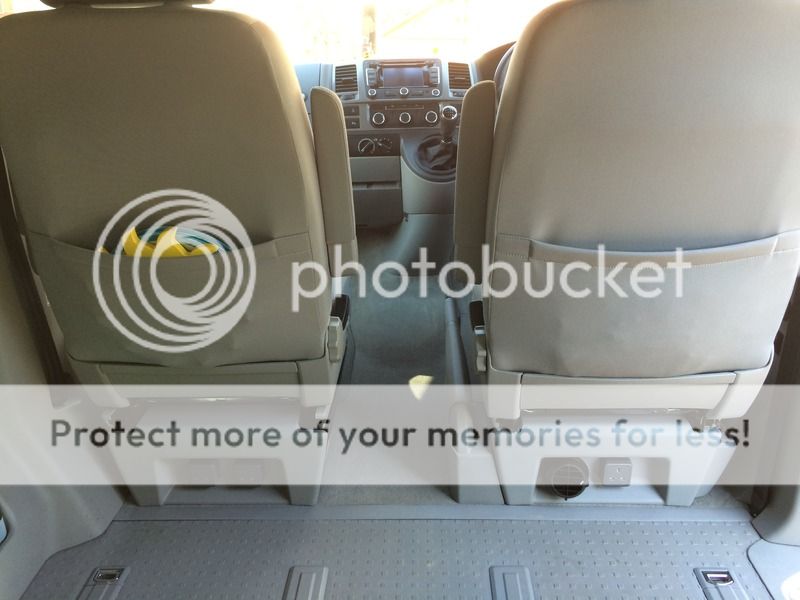

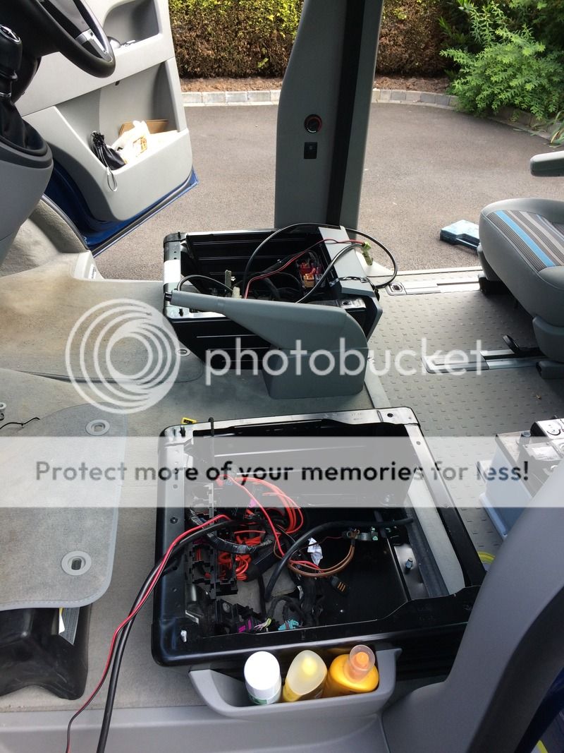

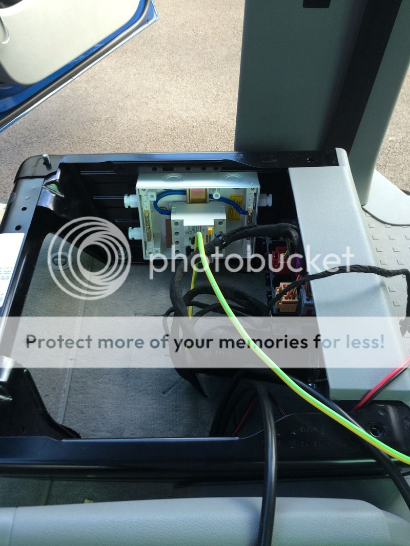

Well today I finally started adding a 230v connection point into my Beach Hut.

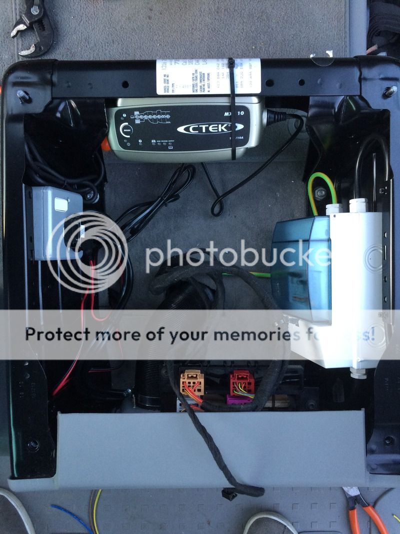

Commando socket from engine bay ran under drivers seat. I have mounted a small 2 way DB and a Ctek 10A battery charger to charge the leisure battery whilist on 230v hook-up.
So far, I have 1 socket outlet on the rear fascia of the drivers seat.
I would like a second socket on the side panel trim under the sliding window. Anyone any idea how this comes apart...???

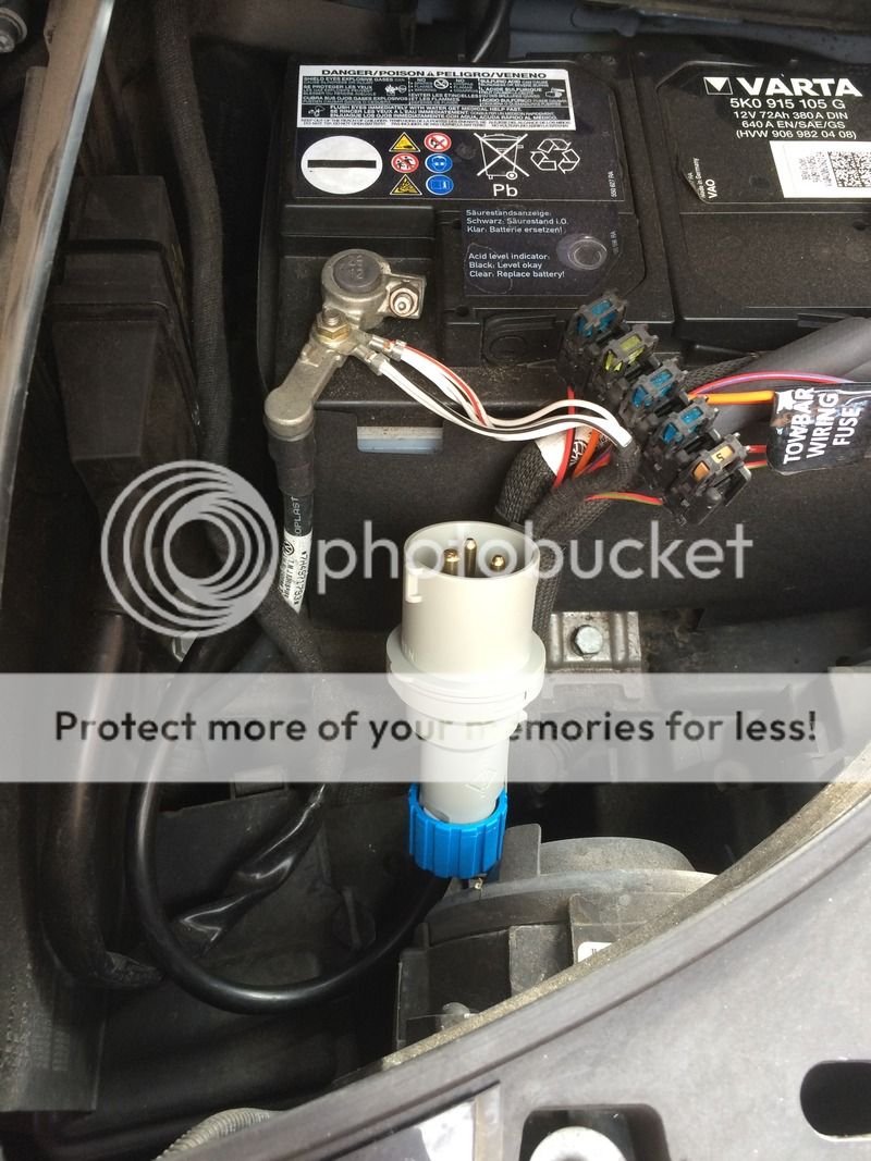

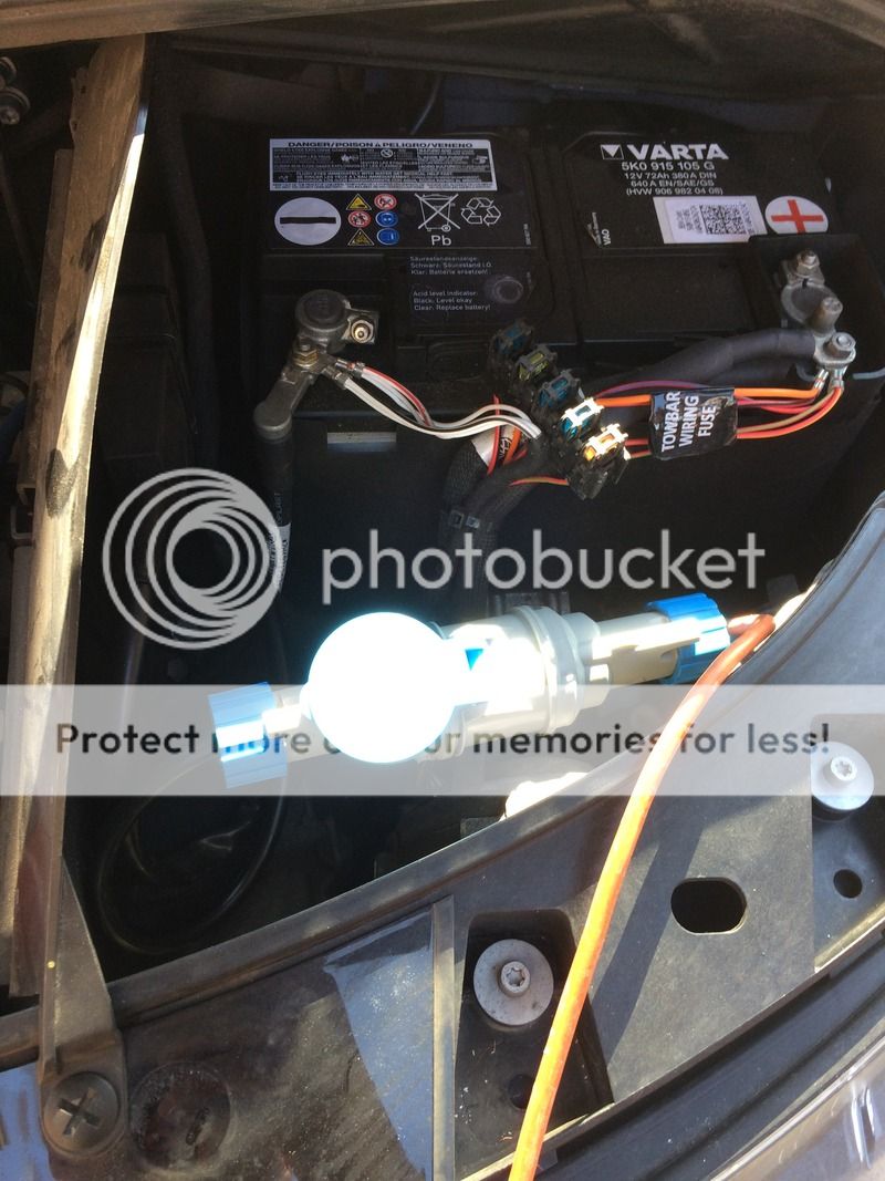

I have mounted the 16Amp commando socket in the engine bay adjacent the battery. I will post some pics when complete

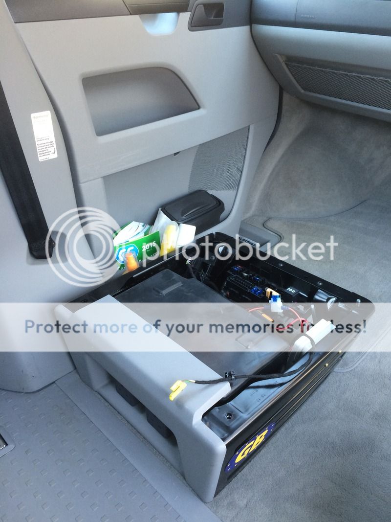

Hey Jonny, leisure battery is under passenger seat.

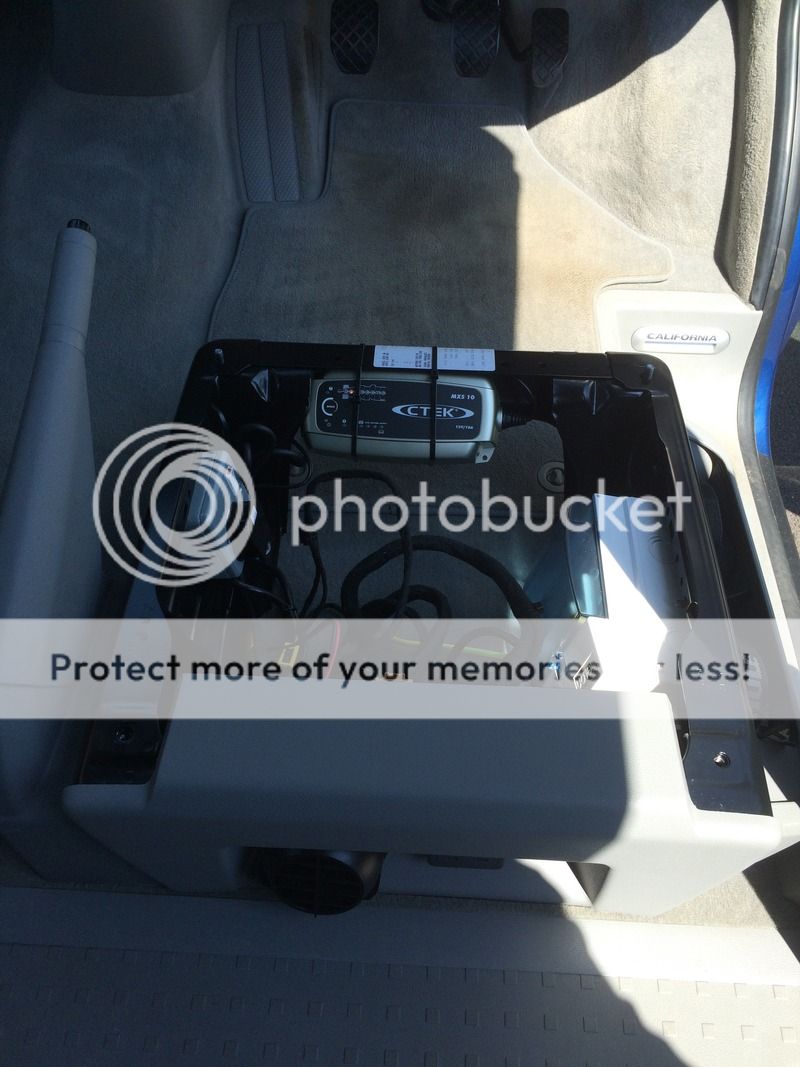

Done a little more this evening, but not quite finished as the leisure battery is in the way of the socket back boxes. Grrrr, there is always something in the way with these vans. Anyway, managed to obtain some spacers and hopefully have it all finished tomorrow evening
16Amp Commando next to vehicle battery.

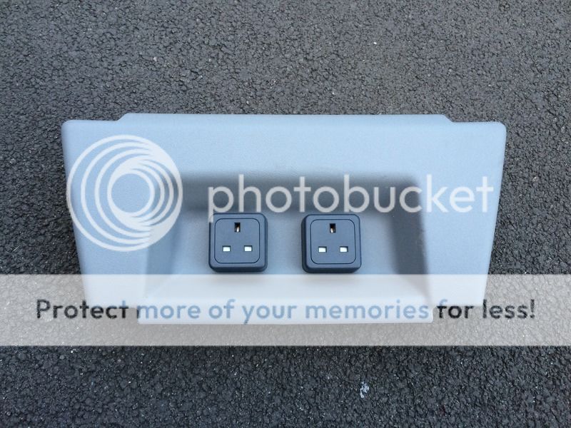

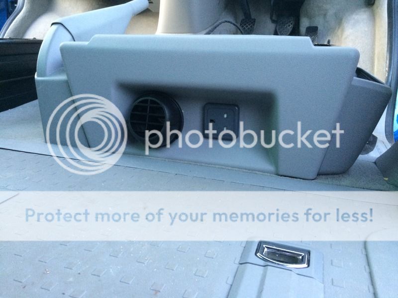

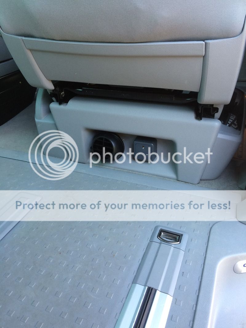

:bananadanceAll finished and working. It's a fair bit of work for a few sockets and a battery charger. But I'm sure it will making our camping trips easier.
Will get to test this weekend in Devon then 2 weeks later in Italy.
Really happy with all the kit. It's hidden out the way and the sockets look almost OEM :bananadance
If anyone likes how this is done and needs advice on anything, let me know always happy to help:thumb

How & where did you route the cable from the engine compartment? and where did you connect the earth?
I followed the cable run from the centre of the dash under the floor to drivers seat. From dash to engine bay is towards the corner. If you remove the wipers and bulk head you should see a grommet which allows entry to dash area.
Earth pin located under carpet, under drivers seat

Takes around 6-8 hours depending how quick you are. Price wise, I think I spent about £250 including the battery charger.

Hey! @soulstyledevon got a question. What powers the plug socket under the drivers seat? Is it connected to the commando via the fuse box? Or is it connected to the battery with a 12v inverter?? Cheers!
We're looknig at getting the T6 Beach, but the to add a 240v hook up with a plug inside (which I'd imagine only works when its plugged in to the mains) costs 889,10 € So just trying to work out the best way of doing it...
All sockets are 230v and will only work on hook-up no inverter. I don't see the need or complication of an inverter.
Nice work (apart from the commando plug location but I've voiced my op on that ;))

I am considering doing this, what physical route did you use to connect your CTEK Charger to your leisure battery please?
You should find it will go under the carpet no problem. There is already vehicle wiring there already anyway.
