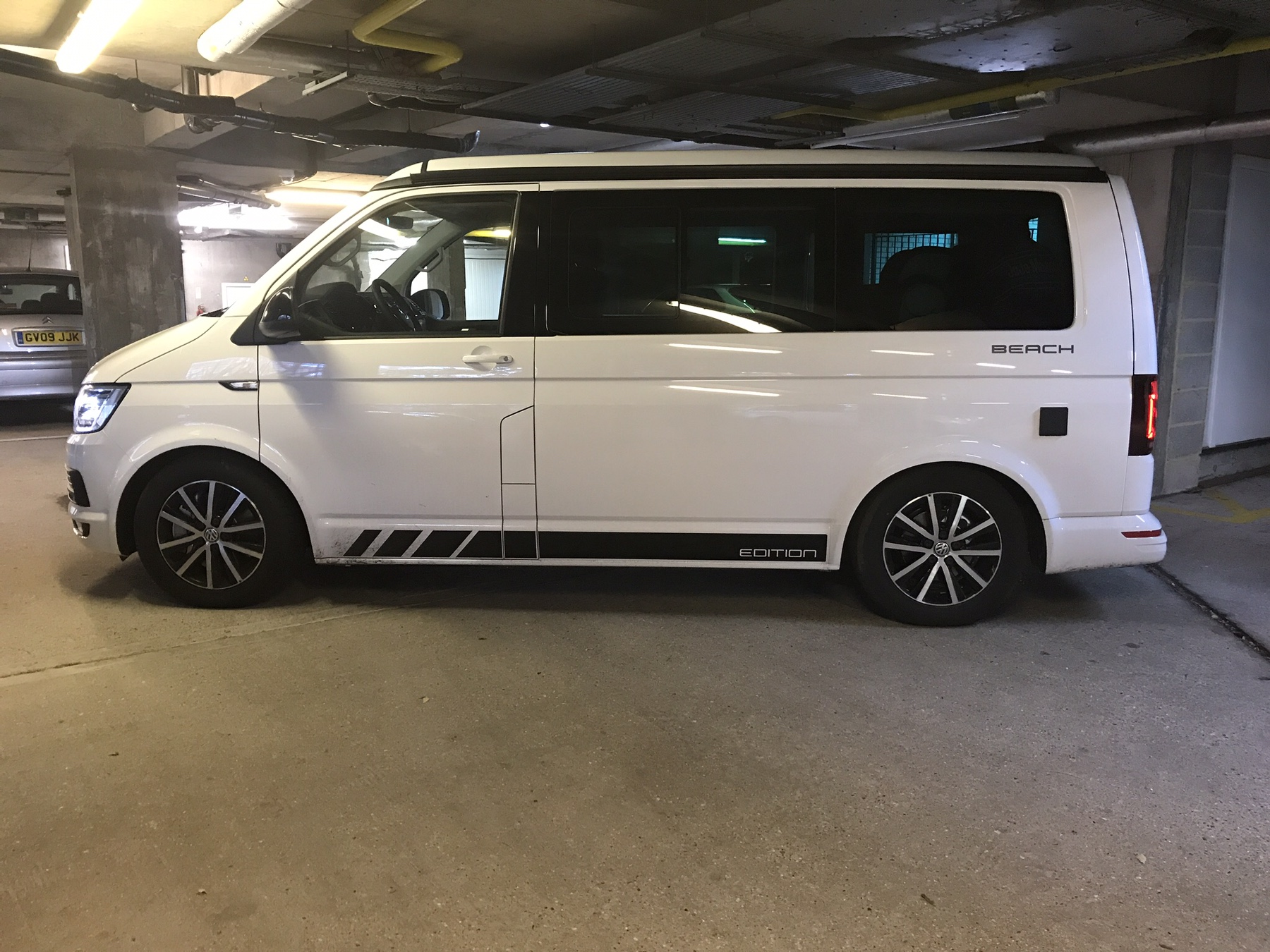

Hi all, had B14s fitted to my Beach today. As I understood it, the ride height is adjustable through a range of -40mm to -70mm vs stock. I asked the garage to lower it as little as possible in that range and naturally expected this to be -40mm.
My reason for this is I think that 30-40mm lower still looks good and is a practical compromise between stock and mowing the lawn with my car.
So, It comes out of the workshop -70mm and the technicians (who do LOADS of these - they had a shop full of T6s) insist they adjusted the coil overs for the minimum drop possible. They said they left only few threads showing at the top of the coilover and they did this as they’ve previously experienced the spring having some unwanted free movement when the setup is at the minimum limits.
1. I’m slightly miffed / disappointed by the result.
2. I look a bit like a clown who just won some cash and went straight down to Halfords.
I’m still on the 17” Cascavels until my new rims arrive and obviously things will look better when they’re on.
Has anyone else fitted B14s and achieved a lesser drop than -70mm?
The Handling has improved dramatically whilst the ride is noticeably firmer and akin to GTi levels of tautness rather than bone shaking. However, I don’t want a 70mm drop - I went with B14s as I wanted the best ride and -40mm. Ho hum!

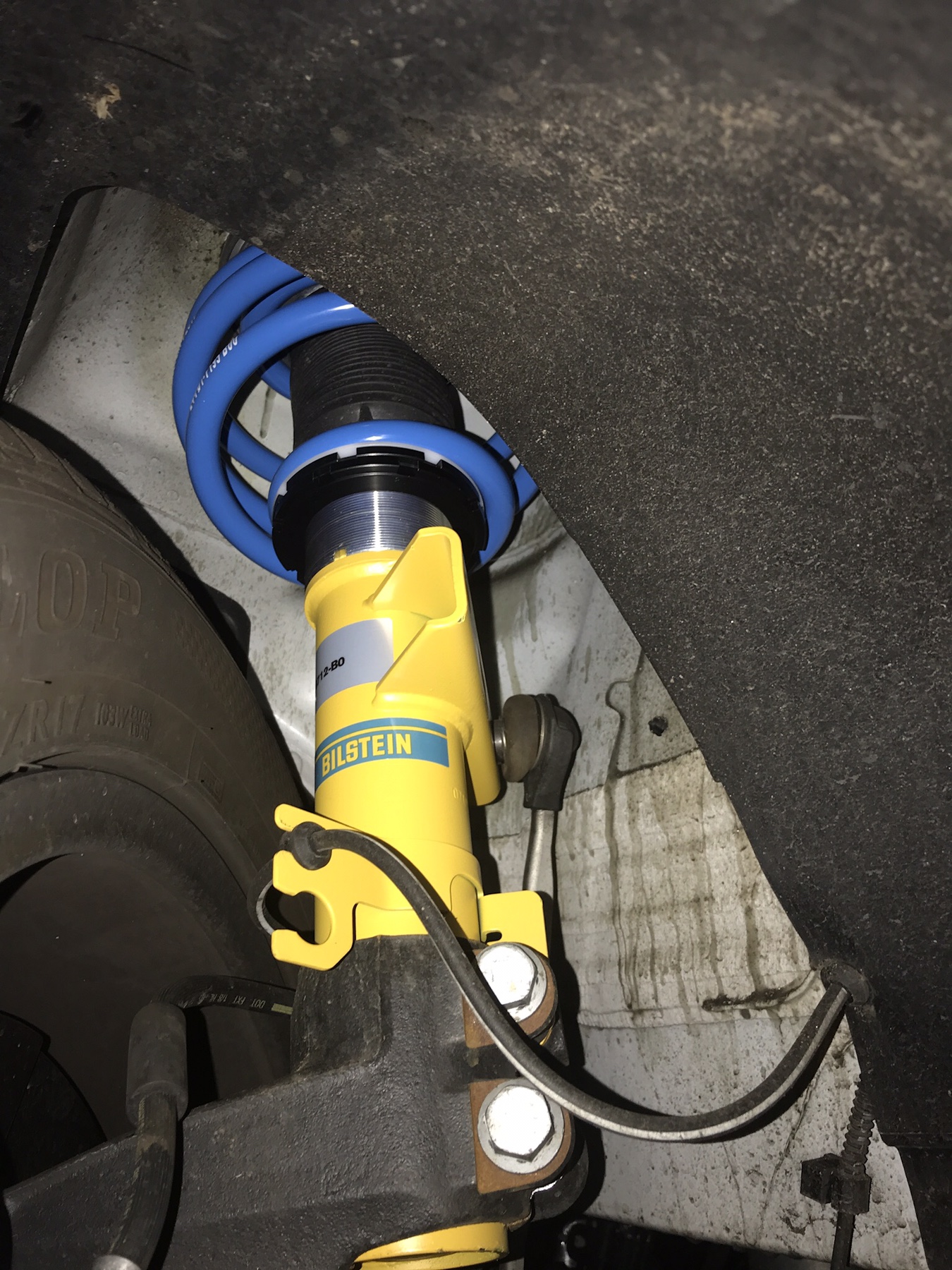

This is all I could see as I couldn’t get my hands in there.
By the looks of it there’s plenty thead left there so the haven’t wound it down very far.
That thread you see that’s left takes it lower, if you screw the castle nut the other way it takes it higher, I think it’s a case of the California is heavy so it doesn’t take much adjusting before it’s quite low.
In all honesty if your changing the wheels I think you will find it’s sat just right,,
Your new wheels will fill the arches more outwardly than the cascavels do..
I would not be disappointed buddy.
if you want it higher wind it the other way or tell them to do it..
The more you wind it up the tighter the spring will be
Not looser???
it has a helper spring this will only rattle when it’s at the lowest setting and for it to rattle it would have to be on the jack not compressed ...the way you want to do it (higher will have the opposite effect,and definitely not make it rattle it’s the latter that would.
but as I say only when it’s decompressed on a jack!!! I hope this makes sense???
Have you got a picture of the van sitting on a flat??
I know I’m going to have ‘limited’ clearance with the new rims hence I only wanted around a 40mm drop. (I suspect the ride may be slightly softer if it’s not so low (?) I’m only basing this assumption on the the techs experience that these go even lower but ride badly) Hence my ‘miffed-ness’ as I read a lot on these and the literature says 40-70mm drop in some places and 30-50 in others. Went the coil over route as I previously lowered a fiat 500 on H&R springs and my wife almost gave birth en route to hospital when I hit a very small pothole/ cigarette butt/cats eye :D these ride much better even at this height.
