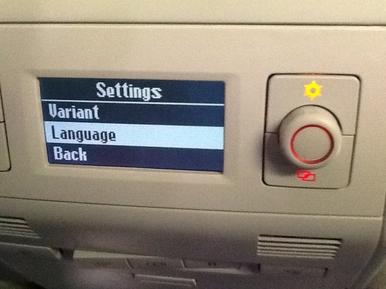

Hi. I have a California 2012 with a German language ”Central Control Panel”. I would like it to be in English.
The Danish Import company (Skandinavisk Motor Co.) Do not know how to do that. Please help!!!!
Hold control knob in and press the button below at same time, then scroll up one line and that will be language change setting, obviously you will need to tranlate from German
Hi there. What you need to do is change the language in the secret menu on the control panel
If you hold down the escape button the bottom right of the panel whilst pushing in the control knob this will get you into a secret menu then scroll down to language to change it to English
All sorted :thumb :thumb
