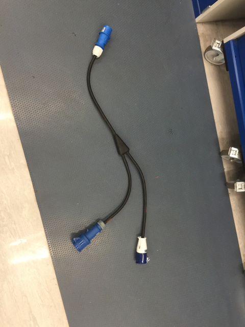

as Welshgas has said you will have to note the limitation of the hook up supply you are given. From what I have seen they are usually 6, 10 or 16 Amp (open to correction). However even if on 16 amp you are limited by the RCD to 13 amp but if you are going to use an awning you could use a 'y' splitter before it connects to your van and then take another cable into your awning connected to a 3 pin socket outlet to utilise full capacity.
I'm going to make a 'y' splitter up tomorrow so I can post a pic of what I mean if you want?

'Y' splitter, one socket to van and one into awning.
We use them in our 'server destruction lab' to fool a server into thinking it has two individual power supplies while it is being tested. Normally have 32amp plugs and sockets on.
