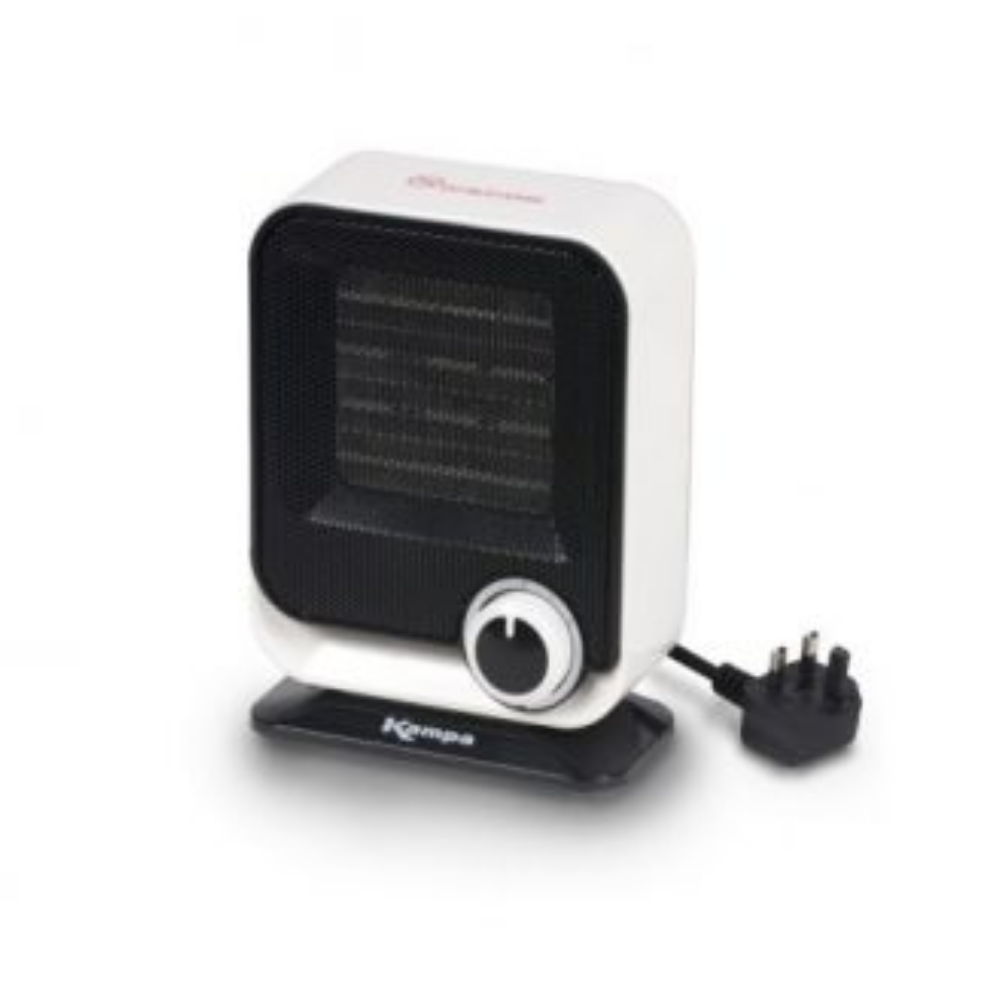

Option 3 is the 'camping heater', using either on/off hook-up. If you're not a winter camper - you might be able to go without. But you'll need opinions from other Beach owners on that really... On hook-up their are little electric heaters you can buy:

If camping on hook up then a small electric heater is handy to have. But note, only the Beach Camper comes with hook up, the Beach Tourer does not have that option.
