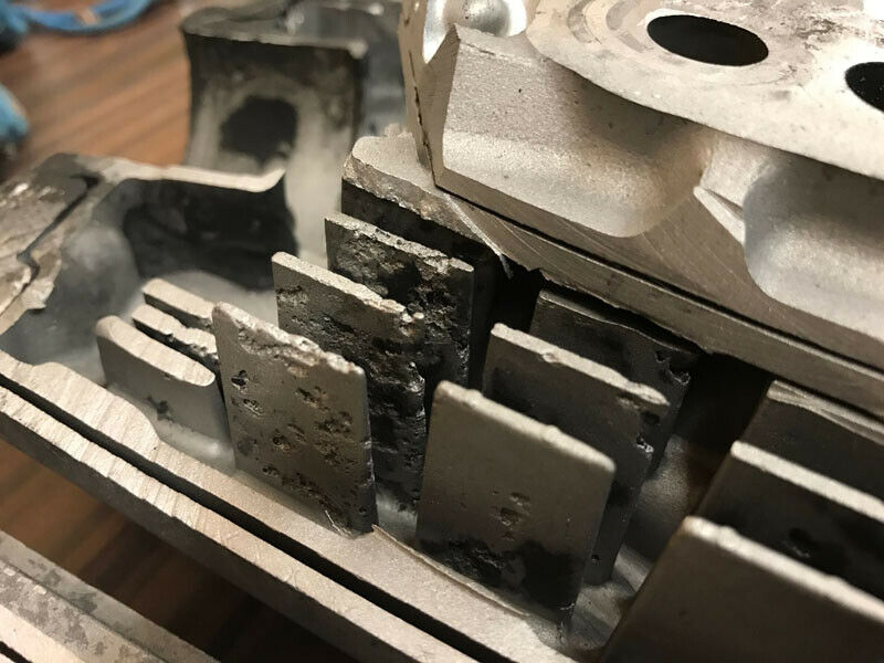

You really do need to read what has been said carefully. The 2010/2011 problem was accepted by VW, who published a TPI. In fact I believe you posted pages of the TPI on the Forum.
Subsequent problems are, according to some , related to self destruction of the EGR oil cooler in some vehicles. As not all are affected no one has yet come up with a hypothesis as to why only some EGRs are affected and not all if the EGR is the root cause.
