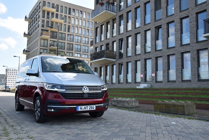

I think the 6.1 lane assist actually gives a nudge to the steering wheel if you wander out of the lane. I don't know if it can do more than that and keep you in your lane. One of the possibilities opened up by VW switching to electronic assisted steering.
"The Lane Assist manages to remain in the lane for a short time without the hands of the driver on the steering wheel. If the car threatens to drive over a boundary line, it is automatically steered gently. After a few seconds, however, the T6.1 asks the driver acoustically to take the wheel. During the test drives on the Amsterdam city highway, it turns out that the technology also provides a piece of traffic education: If you want to change the lane without flashing, you will feel a significant resistance when driving over the line."
