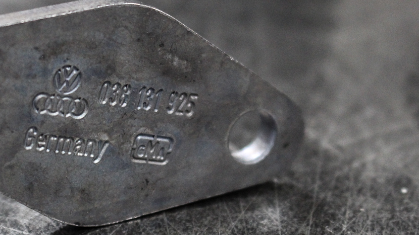

Found the attached site which looks to have a plausible explanation as to what the A sticker might mean. Scroll down to the end where they talk about superseded parts I.e. where they revise a part due to the first version needing improvement, they add a letter to then end of the part number but otherwise keep the the number the same. In which case it’s important that replacement bellows have it. Per my recent pictures though mine had the A sticker on the packaging but not on the label attached to the front zipper, so all is not lost if your label doesn’t have it. Maybe this is where the importance of the 9th November date comes from. Might still be just Fabsil of course!Maybe the extra QC is “Fabsil applied at factory” and then they put the little ‘A’ sticker on.

I don't think it explains the A sticker.Found the attached site which looks to have a plausible explanation as to what the A sticker might mean. Scroll down to the end where they talk about superseded parts I.e. where they revise a part due to the first version needing improvement, they add a letter to then end of the part number but otherwise keep the the number the same. In which case it’s important that replacement bellows have it. Per my recent pictures though mine had the A sticker on the packaging but not on the label attached to the front zipper, so all is not lost if your label doesn’t have it. Maybe this is where the importance of the 9th November date comes from. Might still be just Fabsil of course!
VW Part Numbers Explained
This blog attempts to explain the VW Group part number system. The system used dates back to the 1930s and the original designs created by Ferdinand Porsche. It may look scary, but once you learn the basics, you’ll find that the system is quite consistent and makes things easier to understand...www.darksidedevelopments.co.uk
