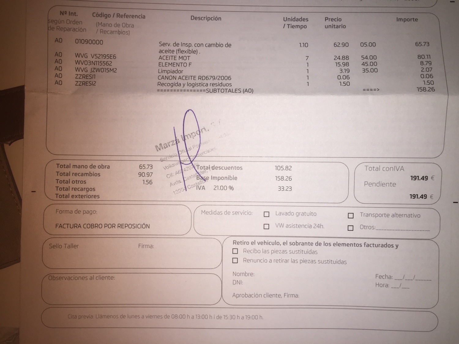

Out of interest, roughly how much did the oil and interim service cost?
€191 including 21% VAT and windscreen wash.
