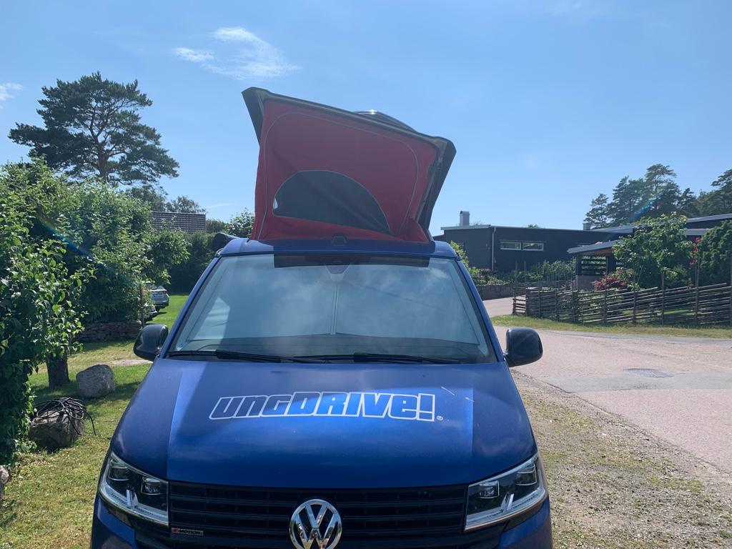

Here’s how mine looked after 2 days outside a friends place. The manual says the auto-adjust function is supposed to run every 5 hours but I only heard it 2-3 times ever… also got it stuck completely 2-3 times (could not move up or down without removing the leisure battery = reseting top panel).
