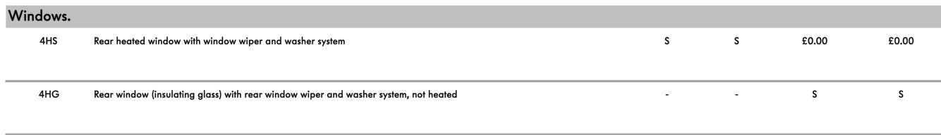

i was very surprised when ordering my new Ocean that the rear heated window wiper and washer system was not included by default and that you had to choose the option explicitly to get it. I asked the sales rep why this would be and he thought that it was a cosmetic issue with people preferring the lines of the tailgate without and as visibility through the back window was so limited then it wasn't really required. I therefore added the option to my order.
However, today I stumbled across a thread here where it was mentioned more or less in passing that having the heated rear window and wiper meant that the the glass wasn't insulated resulting in it being colder when sleeping downstairs and condensation forming on the glass.
Now I'm worried that I shouldn't have chosen the option. I would be far more concerned about being comfortable in the downstairs bed than having a clean rear window.
Is it right that having the option has this effect and should I change the order to remove the option?
I have chosen the privacy glass with heat insulation option as well.

Yes, that is correct. It was clearer in the first price lists available for the T6:

Nothing to do with cost as the option is free but I thought you didn't get the wiper and washer unless you chose the option. They are the most important bits to me and I will forgo the heated window in favour of insulated glass I think.
Time to phone the dealer and change my order!

Just to clarify - I thought the rear wiper and washer was standard whether you chose heated rear window or not? As others have said, it's much clearer in the earlier price lists.
Has anyone taken delivery of a t6 without a rear wiper?
I've talked to the dealer and he has confirmed that the wiper and washer comes as standard. This is much clearer in a VW spreadsheet of options that he sent me but is extremely ambiguous in the printed price list brochure which was what I was basing my choice on originally.
