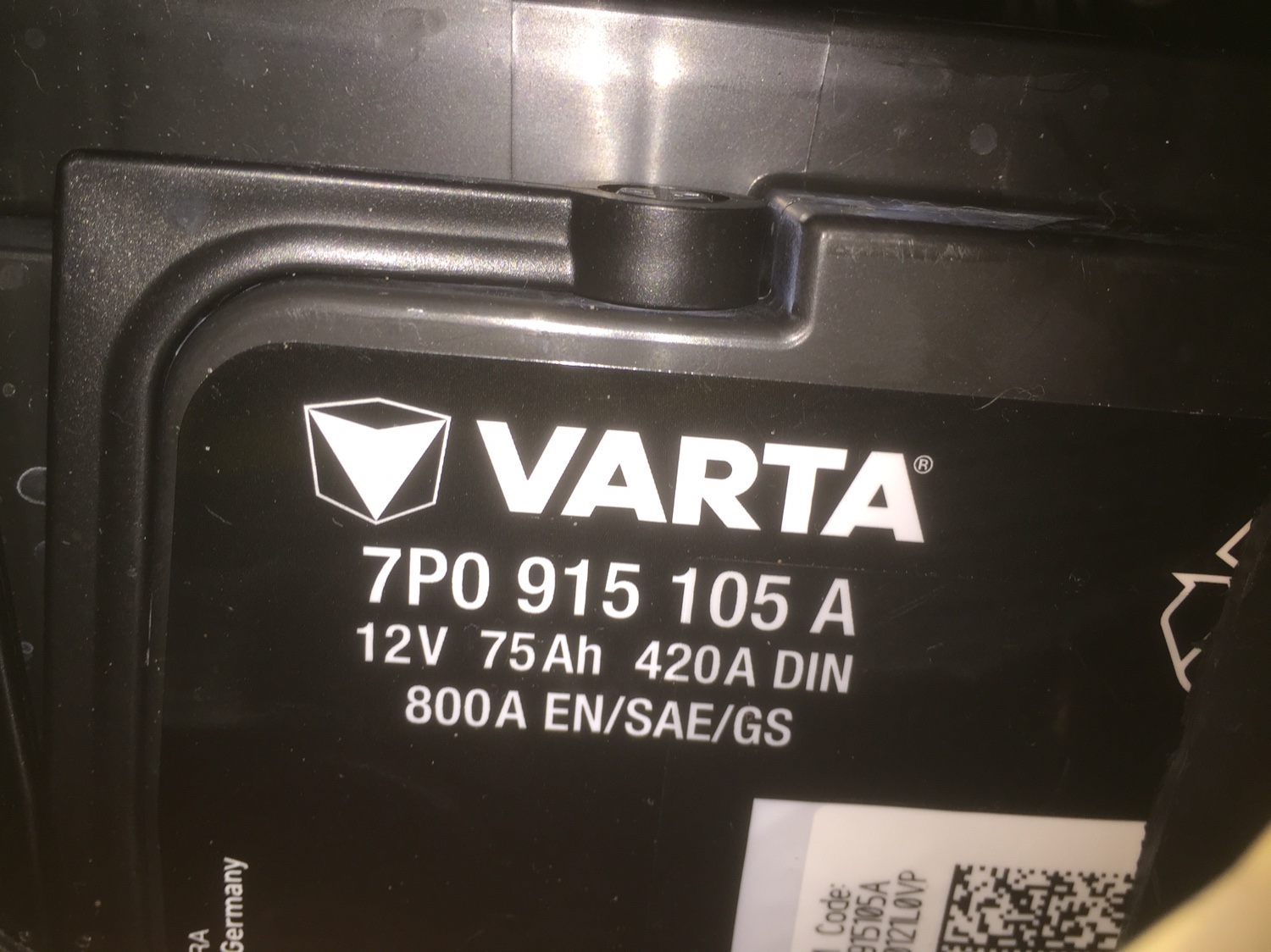

I'd forgotten how hard it is to pull off the battery cover. Made doubly difficult by the fridge, buggy and various items of detritus stored behind the seat.
Are you still using the hook up? Have you got a volt meter? Check output from charger could be an issue with the charge rather than the battery. If that is ok check voltage in battery, after 12 hours on hook up then remove all connections from battery leave it to rest for 1 hour. Should be 12.6v.
Googling that battery number brings up a thread from a different forum with a similar issue & a suggestion for a replacement. Varta F21.

It seems that our battery is of the appropriate type.
We have a short (2 hour) drive to San Marino tomorrow, so we might pop into a VW service centre in Florence on the way to have the leisure battery tested.
Hmm, didn't google the price, eek. But looking now £150 at my local place, Tayna. They have a *star buy* alternative for £90, which appears to be the same make as one as in my conversion, Enduroline. I can't really comment on how good it is as it's only had very light use.

I have just visited a VW service centre. They have tested my battery and confirmed it is only holding ~60% charge. They want the van with the battery in situ to follow VW's battery replacement protocol for 8 hours to charge the battery for that period of time. If confirmed that it is not holding charge, the battery will be replaced under warranty. I have told them that they cannot have my van for 8 hours.
Once we are in Sicily and have more time, do we allow VW to have our van for their diagnostic tests, and see what happens, or do we just buy a replacement battery?
