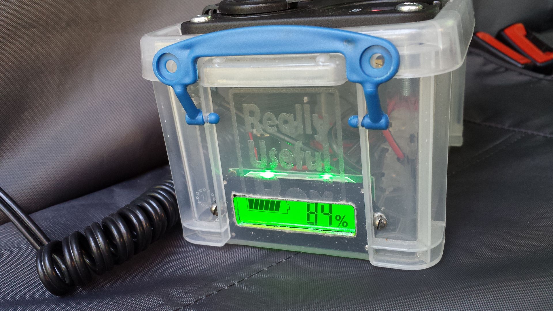

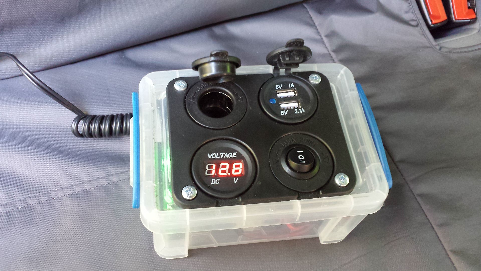

I made this box to charge things and check the voltage.
I also fitted a battery % display which reacts alot faster then the Cali control unit.
Both the voltage and % agree more or less with the Cali CCU which seems to be well buffered.

Are you please able to advise how/where your self made unit is getting its info from ?
How does it get the info to show your % remaining in the leisure batteries ?
