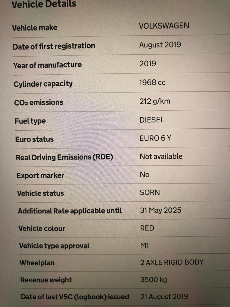

No, not simple! Just did some detective work. Looked up the Grand California reg from an auto car review. Vehicle is listed as an M1 type approval which is a passenger vehicle akin to a car so car limits maybe applicable

This is so confusing and I don’t think even HMG understand it, given the amount of flip-flopping that happens from time to time, but the UK Government website’s definition of unladen weight is:
“The unladen weight of any vehicle is the weight of the vehicle when it’s not carrying any passengers, goods or other items.
It includes the body and all parts normally used with the vehicle or trailer when it’s used on a road.
It doesn’t include the weight of:
* fuel
* batteries in an electric vehicle - unless it’s a mobility scooter or powered wheelchair”
So VW’s definition is not in line with the official definition of Unladen Weight, and is much closer to Mass in Service as specified on the V5C.
The UK government definition of which vehicles have the lower speed limit are: “Motorhomes or motor caravans (more than 3.05 tonnes maximum unladen weight)”.
I don’t understand the insertion of the word ‘maximum’ into this - seems spurious.
I have also read (but on a caravan Club document not on an HMG website, so not definitive) that dealer fitted options are classified as part of user payload and not unladen weight.
So my best guess is that you can deduct the fuel and driver from the VW brochure ‘unladen weight’ to get the official definition. But in practice I don’t know how this is recorded against the vehicle, if at all, by DVLA.
Not sure if any of this helps or just muddies the waters further!
