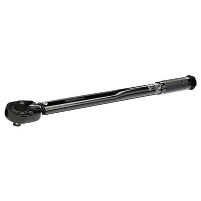

I bought one of these recently. Cant comment on suitability but its cheap!
60-210nm on the box not used it yet.
That's the cheapest one for sure and 3 years warranty !!

I got the Aldi one, as 3 years warranty for £17 is a no brainer :cheers
