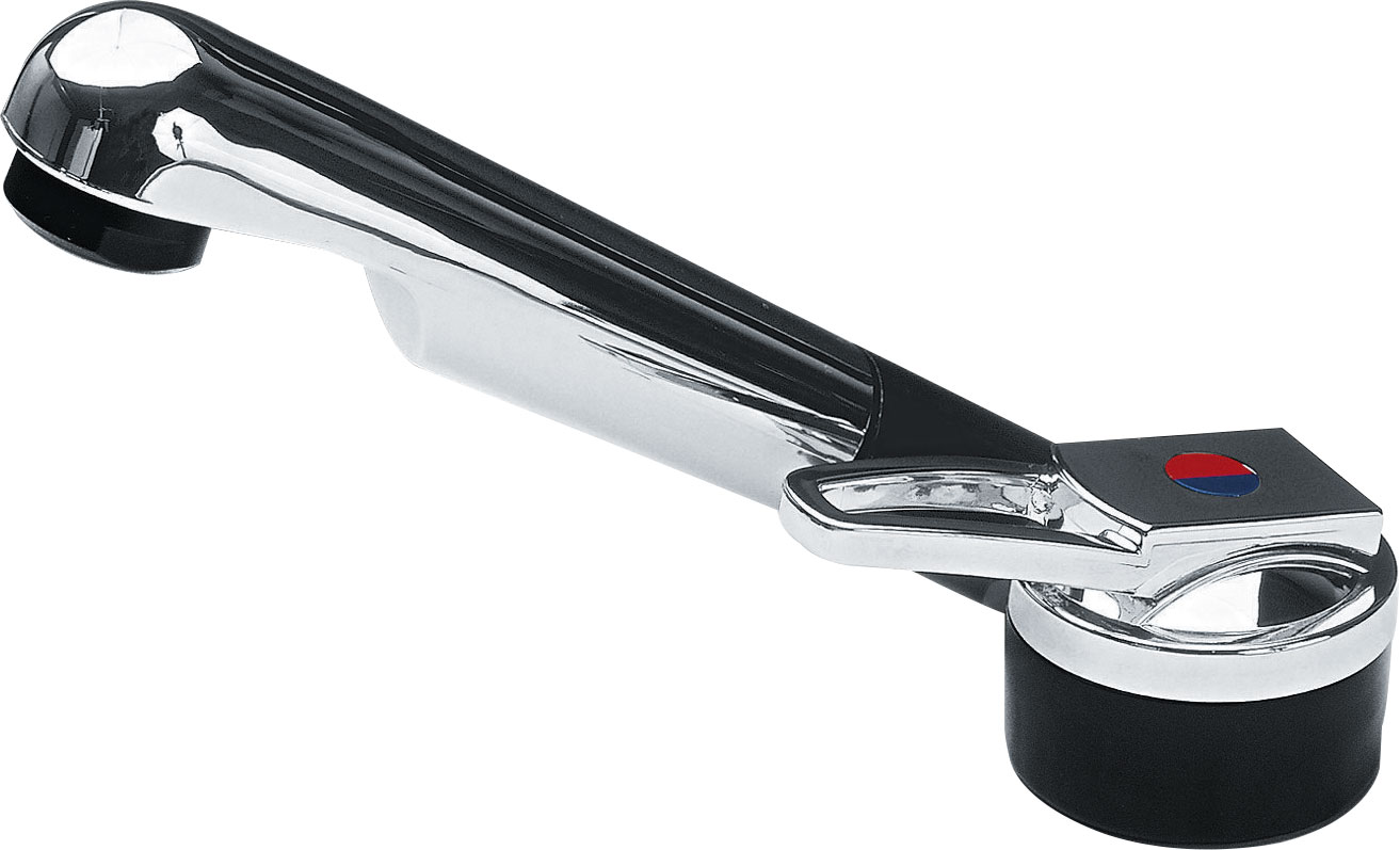

Hi, I ran into a problem with GC600 (early 2020). The waterpump keeps running even without any tap open.
Checked the fuse - It's ok. When I put I back, it starts running again.
Check the outdoor shower, it is turned off.
I opened the water tank; the pump is (logically) got. But no symptoms of anything wrong.
Any idea what to look for?

We are on our 3rd day of NC500 trip and once again the kitchen tap has started playing up after two days of use. kitchen tap now seems to have taken whole water circuit out so nothing is working. No loo flush, shower tap, external shower or kitchen sink! Does anyone have any ideas please?
we can’t pull apart the connector under the sink as VW garage have made it too tight after the first time it went in for new tap. won’t come apart. Turned off elec supply from the fuse box to try reboot but didn’t work. Would be grateful of any help as we are literally near John O’Groats - so far from home :((

You’re going to have to somehow pull that connector apart and check to see if any fuses have blown.
No fuses blown. Have one pair of pliers but couldn’t get it apart. Will see if we can buy/borrow another set to hold on to both ends tomorrow. Meanwhile got the hairdryer on the tap to see if drying it out helps? Slid a bit of kitchen towel under it earlier and it came out wet through.

Linda are you sure the fuse has not blown ie second one in on the left in the electrical cabinet. Think it’s the brown 5 amp.

I think you will find there is a clip holding the connector together. I would be very surprised if it didn’t have a clip and just trying to pull it apart with pliers probably won’t work.
I concur with welshgas. Connectors usually lock together using some sort of clip. They need pricing apart gently with a small screwdriver. In this case I wouldn't worry too much about breaking the connector plastics. But if that was shorted it would just run the pump all the time? Still worth taking apart as it may be down to earth. Could it be the pump? Does the pump supply the toilet on these things?

Thank you so much for coming back to me so quickly. None of the fuses had blown. Had turned everything on and off again with no joy. As a last resort I got my hairdryer on the kitchen tap as I know somebody on the forum in the past suggested this and after literally 20 minutes of hot air blowing on the kitchen tap everything is now working, but we are not going to go anywhere near the kitchen tap again for the rest of the trip! Hopefully everything else will continue working. Just so miserable. Recording all of this as booked in for investigation when we get home.
I take it you have not had any issues with yours? Tried my best to keep the sink/tap area dry but didn’t make any difference.

Hi Linda,
Pleased you have it fixed for now. Lucky enough for now. I do my best to keep water from the tap area! Ironic is it not. A damn tap and you can’t get it wet.
Great news with the hair dryer.
VW have got to do something about the tap spec. So many owners with the same issue.

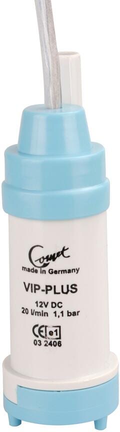

It seems that the tap in the kitchen is responsible for a lot of the water supply issues in the camper.
At the moment my GC 600 is with the VW dealer to get the tap, pump and camper control unit changed (God only knows how long that will take now).
I discussed this with my VW dealer. He agreed, if the issue comes up again, to install a different tap and water pump for me. That is fair.
I plan to get the following in:
I would love to have a tap from Comet, but it seems they have no tap that fits into the Dometic MO 9722 R (27mm tap size). I hope latest after that change it will work more reliably.

Apparently the pump is available now from your local VW commercial stockist I will be placing an order shortly for when I’m away if I ever need to replace the pump I’ll have one at hand.

Hello Jester,
If we start our tour through Scandinavia next year I will ensure that we will have a spare pump as well. But at that stage the original VW pump will be still working or we will have the Comet pump installed.
Equally the tap. Either we have no further problems with the original VW tap or we get the tap I mentioned above or a similar tap von Reich.
I contacted Comet Germany about their taps. Unfortunately their taps are 33mm or bigger. I will not ask (or expect) my VW dealer to widen the installation whole for the tap. I would have prefered the Comet taps, because they are all IP rated. I could not find anything for the taps of Reich.
But normally Reich has a good reputation. So I hope that not all taps are bad.
