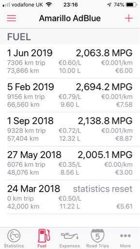

Here my love of numbers may provide some answers. I’ve been logging my AdBlue consumption using Road Trip, so after a sufficient distance has been driven will be able to report on any significant change in consumption.

Hmmm....its been saying 4k miles and min/max 1.25 gals for the last more or less 500 miles. I'm beginning to think something is wrong. I am more surprised that the min and max fill number is the same than anything else.
Update? What update is that? My Cali was new in June '19.
