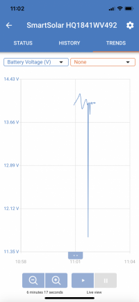

I'm measuring the voltage with the Victron Bluetooth controller. It was ~10.9 volts yesterday & parking heater wouldnt come on (hence why I checked it).
Put it on electric overnight and was 13v this morning but still not properly charged I think as heater would still not come on and watching the victron, as I switched on the heater the battery voltage dropped to 5v.

Thanks for your advice -- In the end by the time the 100A fuse arrived, the van was due a service so I let VW look at it.
In the interim I noted that actually ~13v was being measured at battery (on the victron controller) during engine running. Battery still measured 13 volts or so when engine off - but immediately dropped to anything between 5v and 10v when parking heater switched on (which meant the parking heater switched off immediately)> I was starting to think that the battery was the problem instead.
VW had a look and found that there was a loose connection at the leisure battery terminal -- having tightened up the connection all seems fine now. I'll test over the next few days.

Downward spike is parking heater switching on before I got the loose battery terminal connection fixed
