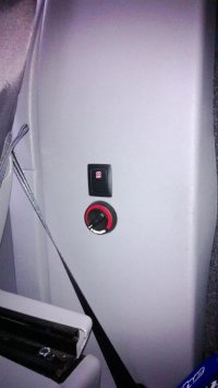

Its going to have to be lower than the lower one, our arm rests will be a tad close. Will have to make sure it does not catch when rotating the seat !!
Its not going to go at the top I'm affraid, as you can see from photo the seat belt adjuster will be in way. There is a plate that actually goes up into head lining when extended fully up !.

Thanks for posting the photo - it looks like a neat job.
How do you find the control there - ok? Would you recommend it?
Also - have you got the heater under the van or under the seat? Would you do the same again?
