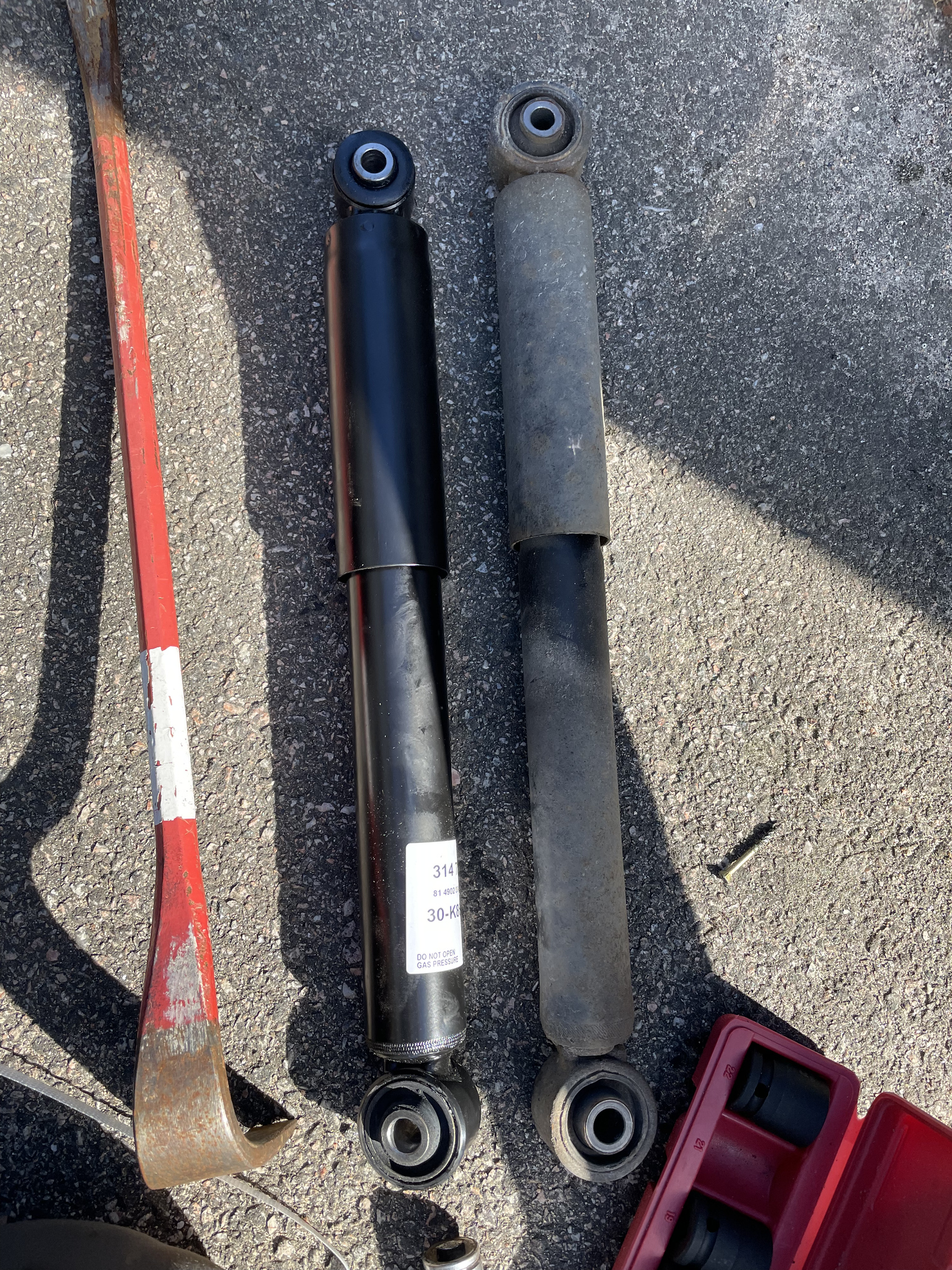

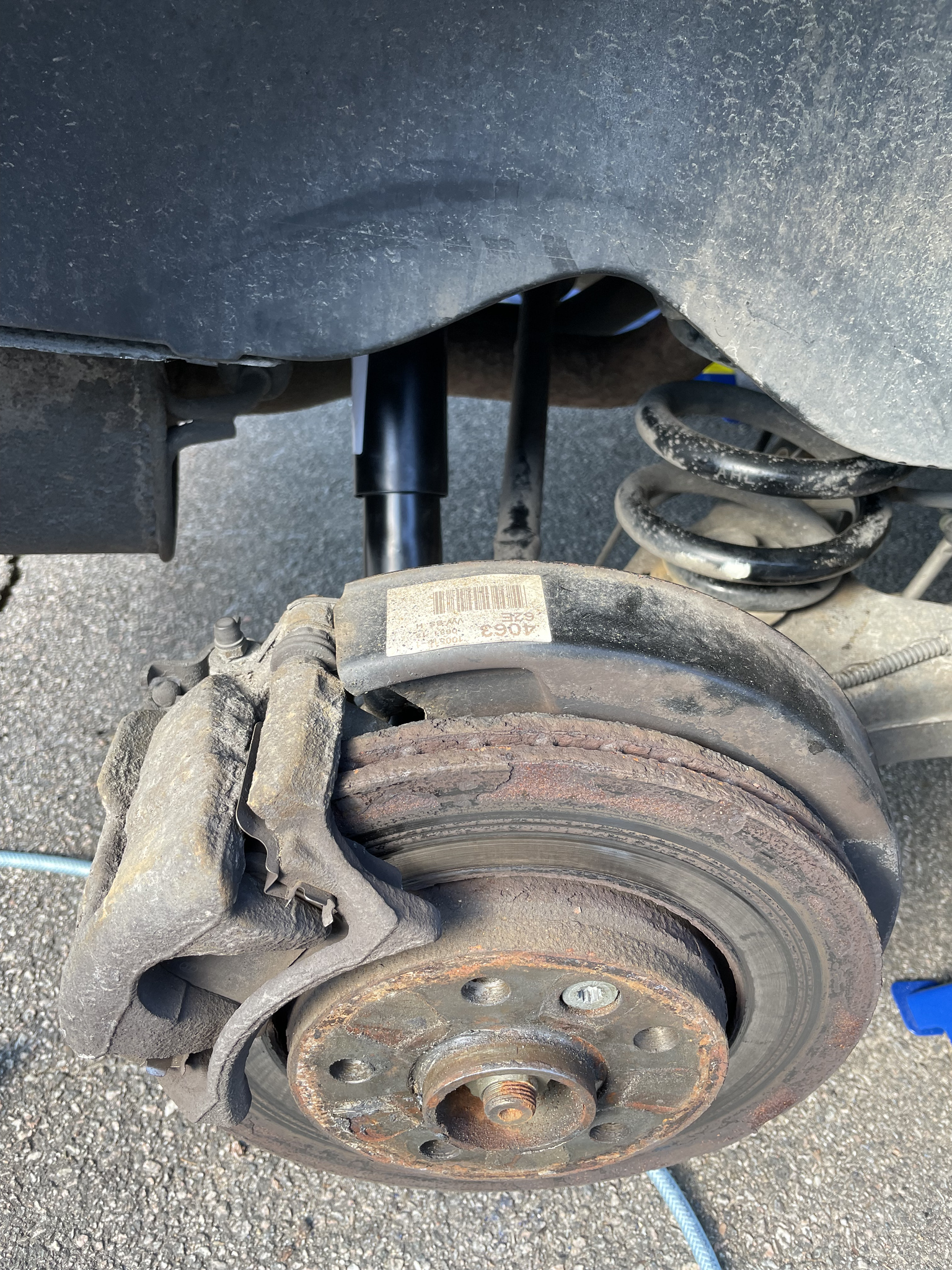

So, the Sachs HD have arrived and replaced. Will start with springs today. Found a tip where you use a bottle jack to lower the suspension arms enough so the spring can be removed.

And here we are, changed springs, roll bar and sachs dampers. It really changed this van to be something much better to drive. A bit of a hassle since it is 4 motion but could be done at my drive with few tools. Thank you @WillSS for the great pointers. I followed all three advices.

Hi, just picking up on this thread as I embark on the same route to improved suspension as yourself. Are you still pleased with the outcome? You say there were extra difficulties fitting the springs because of the 4 Motion, what were they? Did just require more fiddling and pushing down the swinging arms or did you have to disconnect the rear drive shafts.

Having the rear driveshafts doesn’t help dropping the hubs enough to release the springs. Sounds like @kave didn’t need to disconnect the driveshafts but used a small bottle jack to help lever the hubs down.
