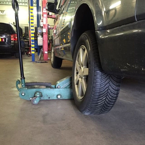

I replaced the tyres on my secondhand T5 (Viking...) als soon as I could. I was looking for 4 seasons with decent winter qualities and found that the Michelin Cross Climate should be a nice choice: a new developed tyre with real good 4-season quality. Since our first trip was planned to Norway (Lofoten) in early May there was a chance to get some snowy conditions.
The only problem was: there was nobody who could tell me how the performance and lifespan would be if used on a T5. It took me even some days to find the fitting size (215 R65 16C)
22K km (14K in miles) later there is still 4.5mm (front) 5mm (rear) left. (174HP T5 TDI)
These are maybe not as good as real winters but they have got the *** snowflakes so they are certified for Germany in wintertime and they performed very decent in the snow.
