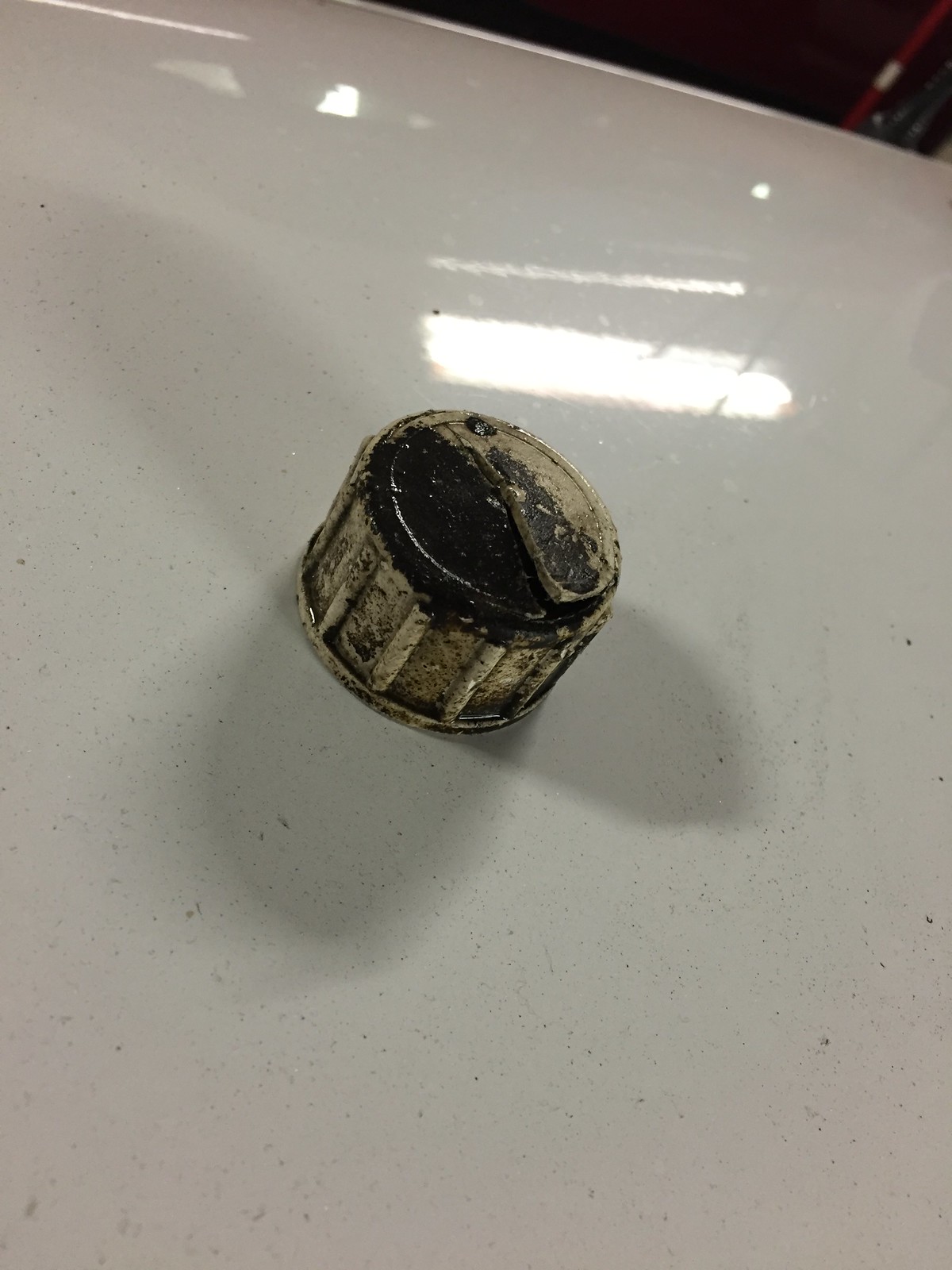

Cheers for those pointers. Worked a treat but I've found the cap for the fresh water is knackered and has been bodged to make it seal. I'm going to check that list on here to see if I can get a new one.
Untitled by Matt Wilde, on Flickr
Don't know if the pop top T4 boys use one of these. May be easier to search for it's a shared part.

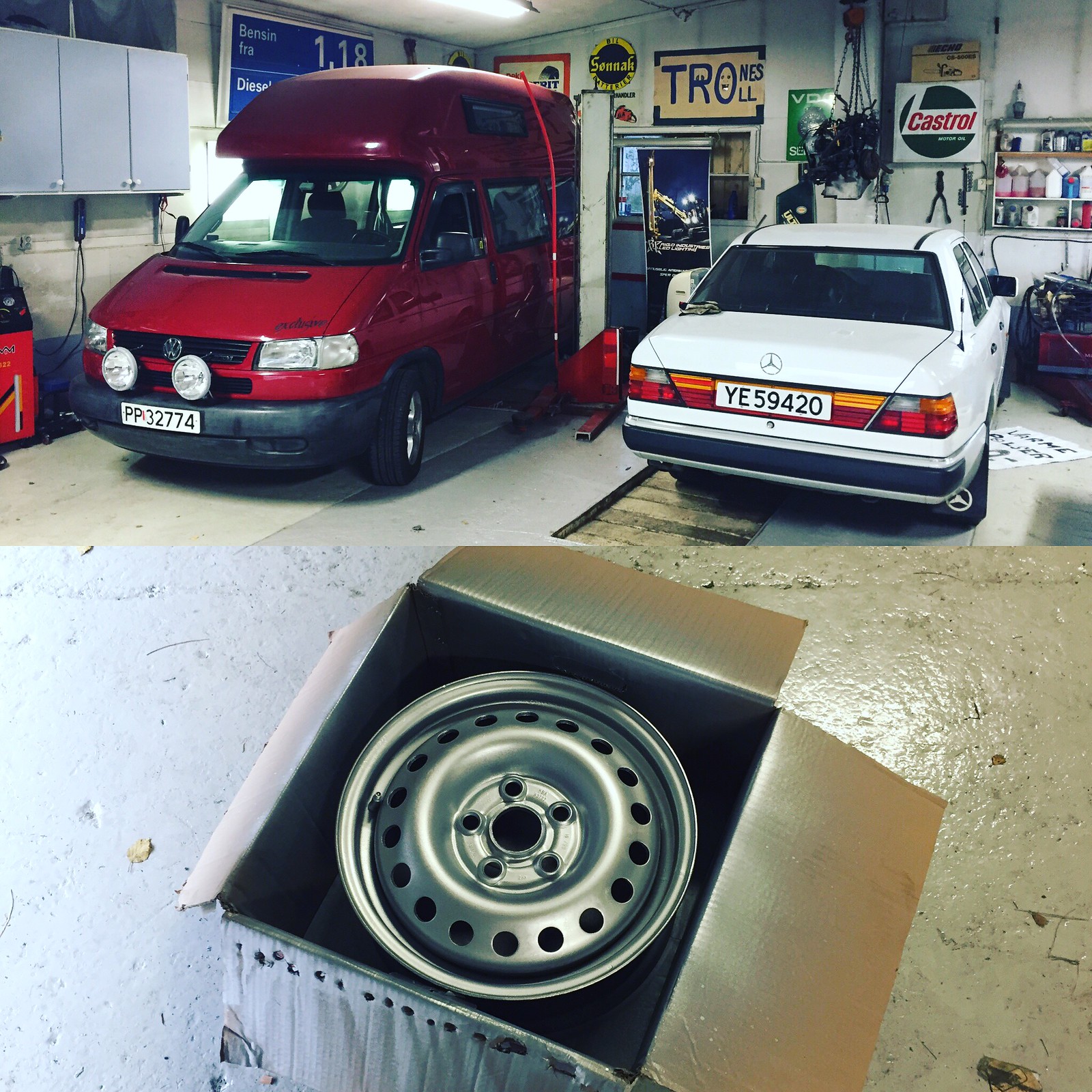

Just got my hands on a set of used studded tyres to so the winter fun can carry on. The van came with a set of winter wheels but they were too far gone. I've been stripping to old steel rims down and giving them a new lick of paint.
