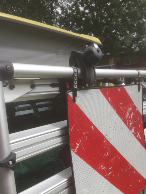

3) The factory installed bike rake flopped with a heavy thump into the down position while travelling on the motorway at ~120km/h in a stiff head wind. This was well over 1000km into the journey, during which time the rack had not been touched. I'd not heard of this happening before, very disconcerting to say the least. Karma for driving with no bikes on it..?? I'll be installing a safety pin to prevent it happening again.

Don't bother with the pin. The short arm does a perfectly good job preventing the rack from falling down.

What a great idea! How good are the chances that if I read the instruction that would be in there...?
Edit:
Had a read at the manual (out of character I know) and was surprised that’s not in there. Should be as it’s simple security. The dealer also failed to suggest it when demonstrating how the rack works. Thanks @Amarillo

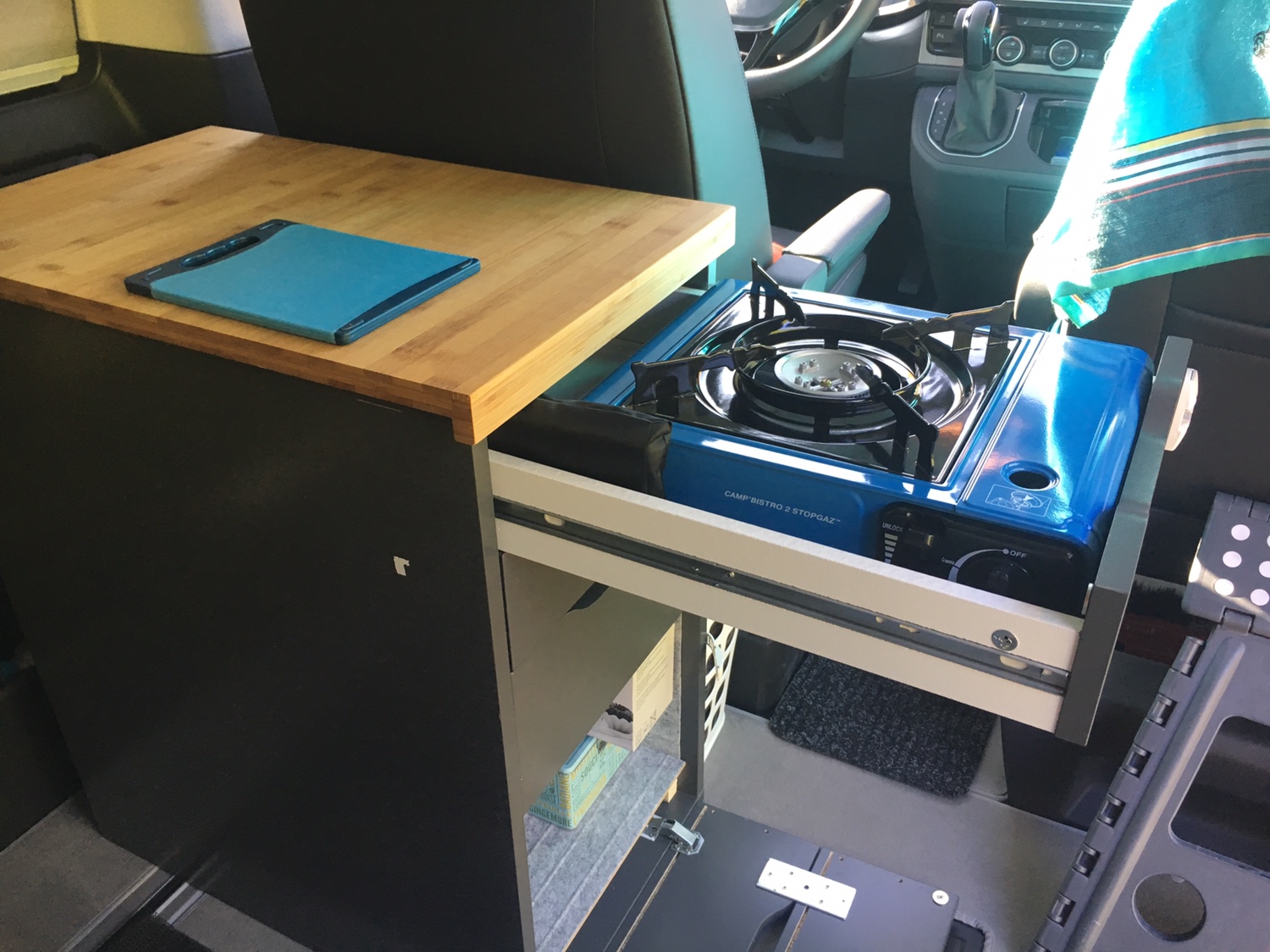

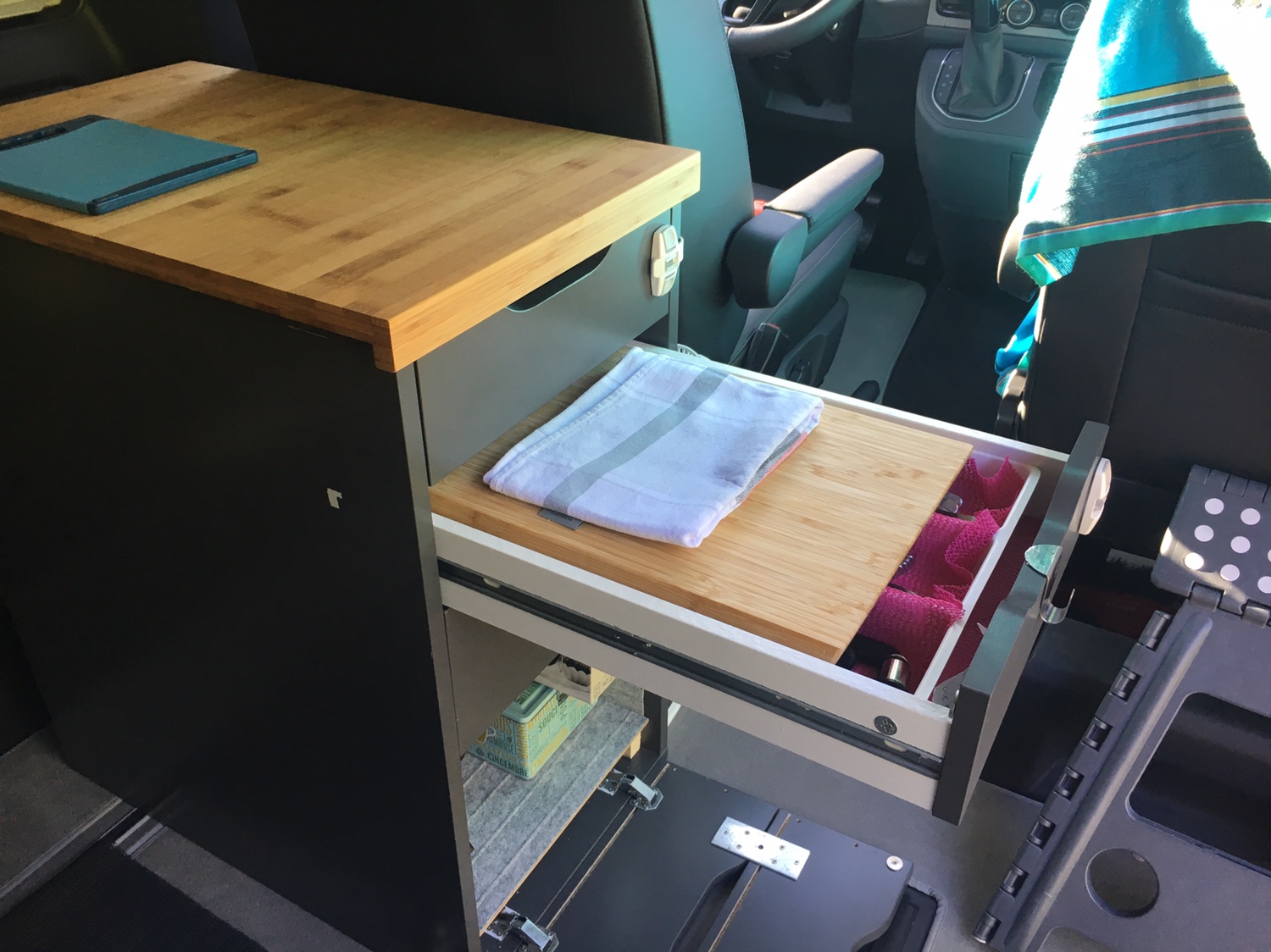

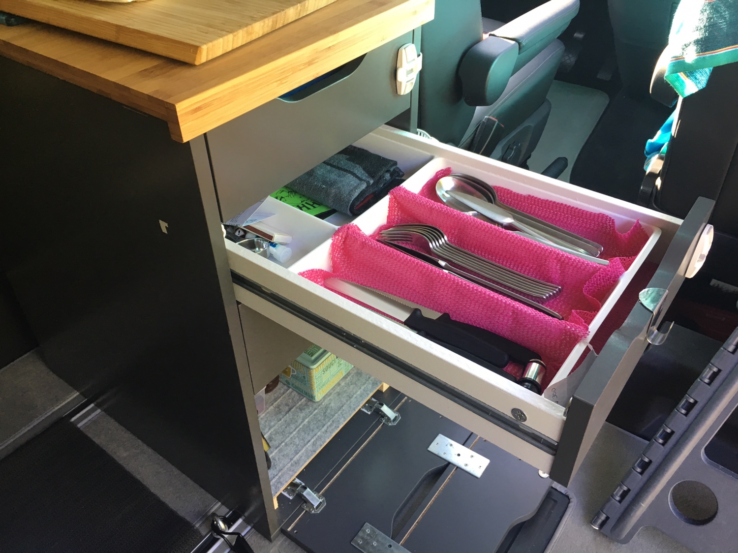

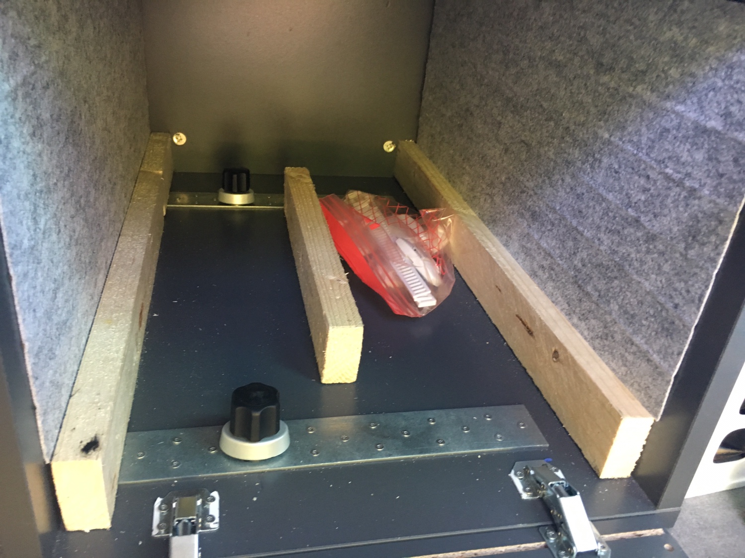

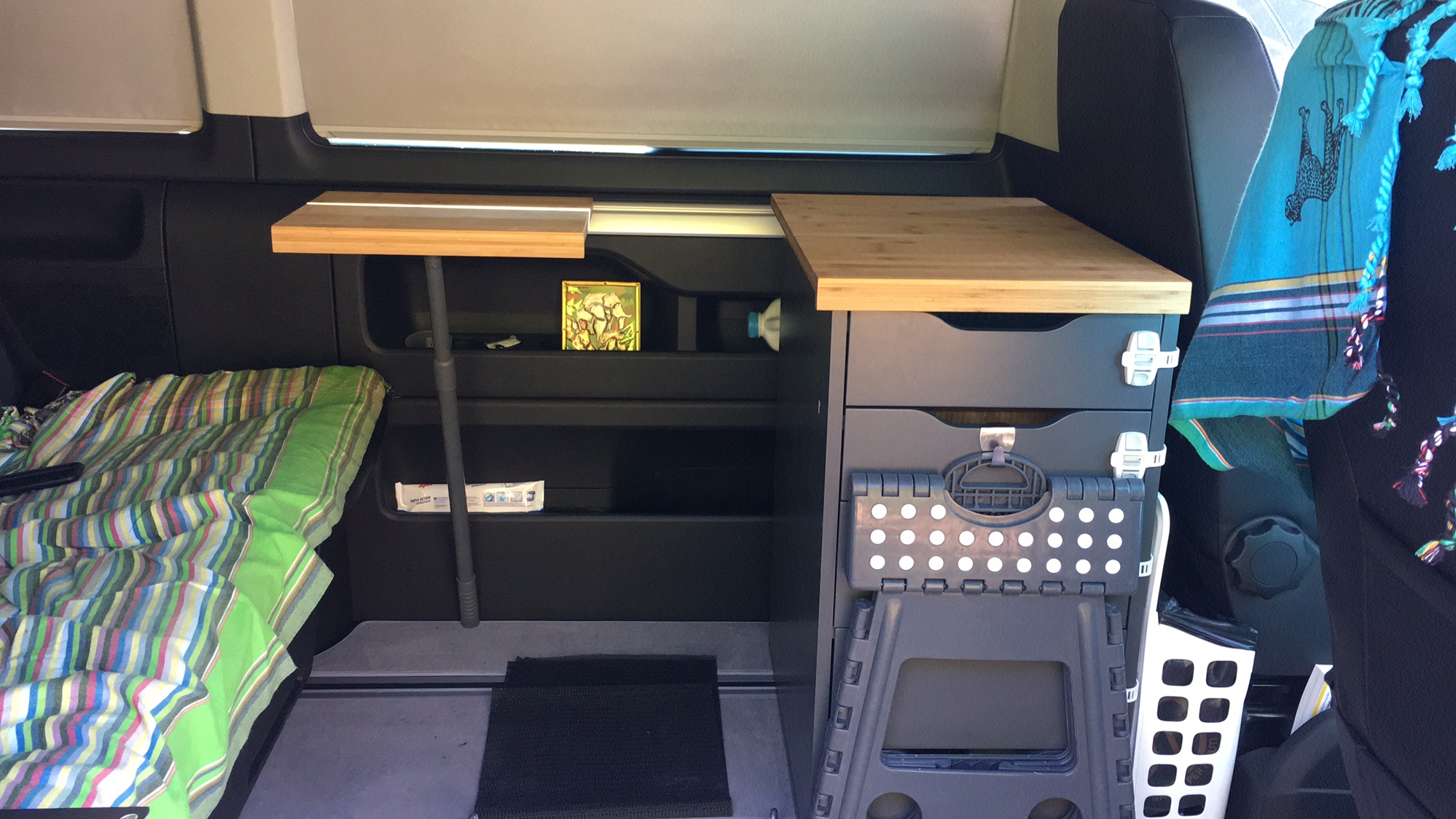

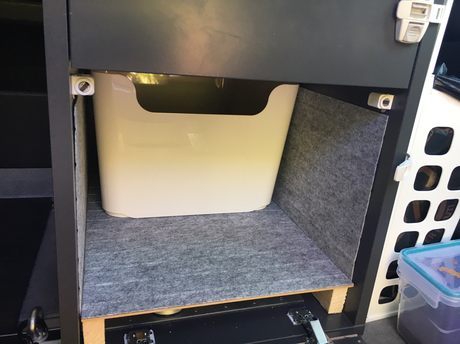

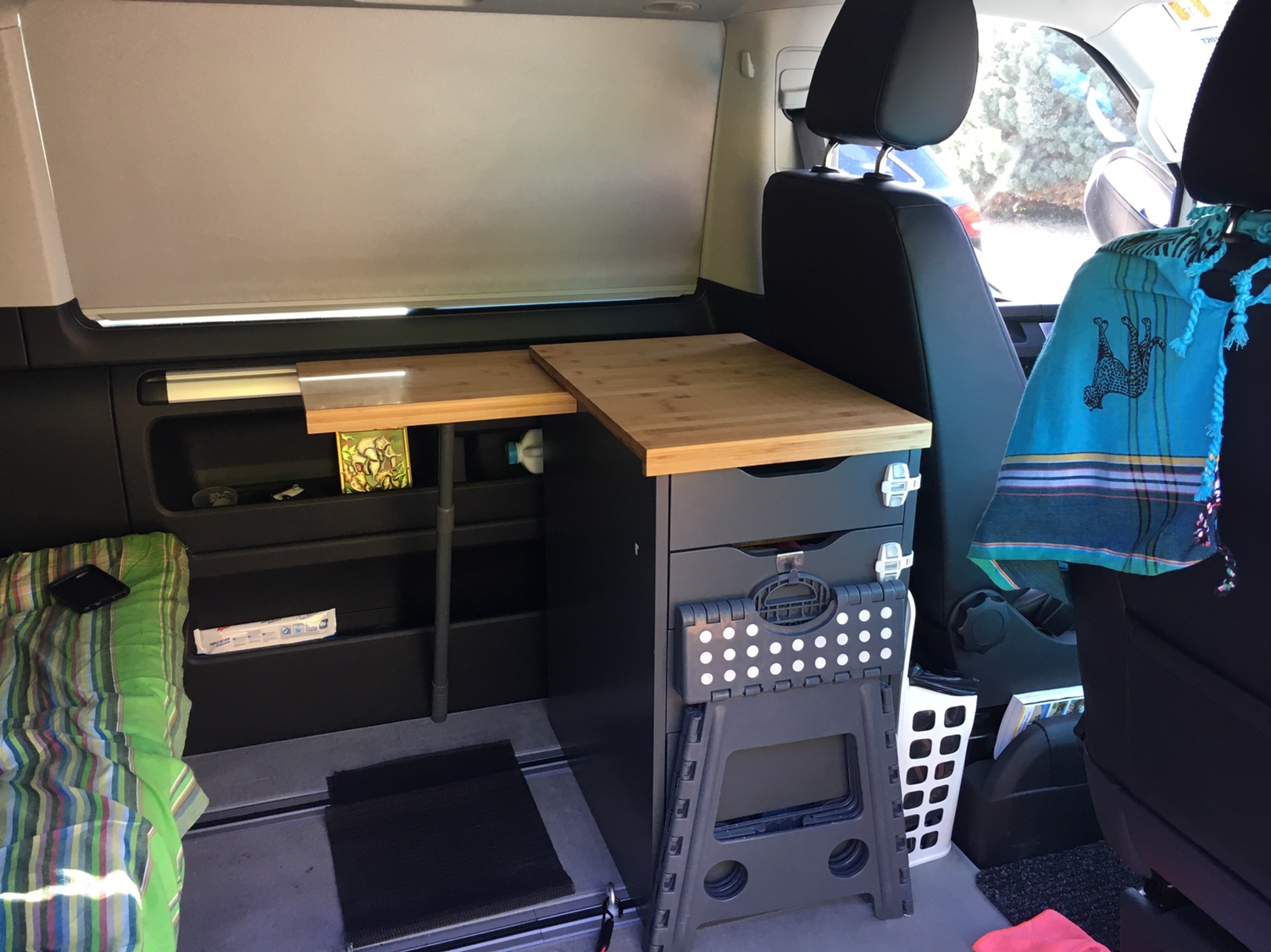

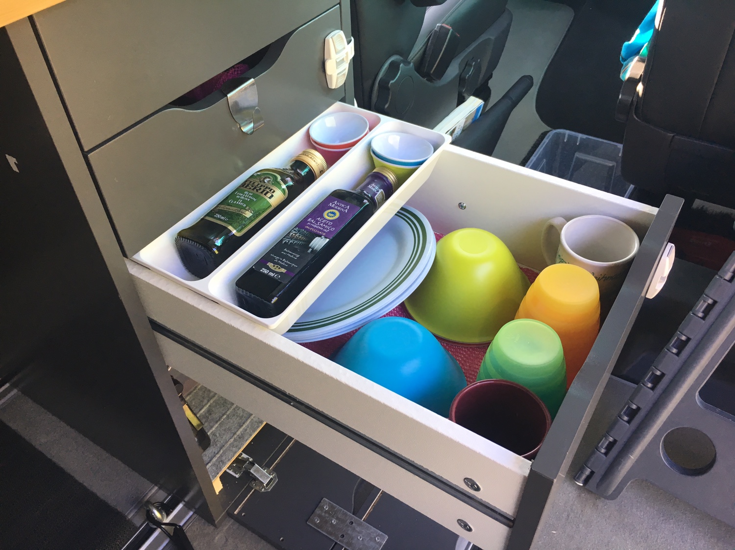

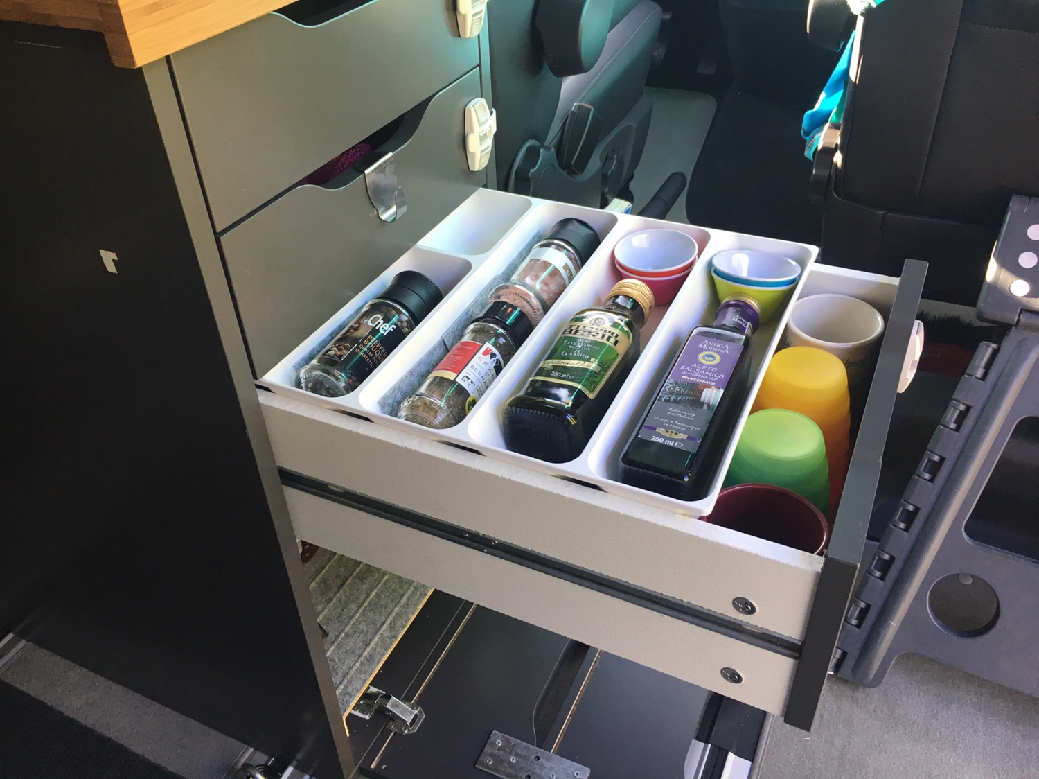

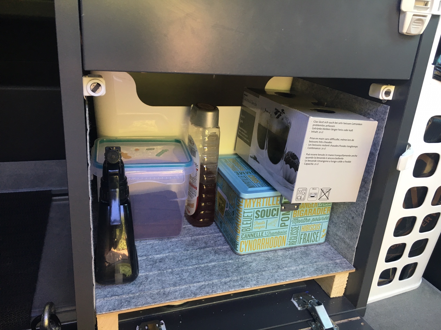

Thanks in part to the many clever ideas to be found on the CC forums, I’ve built up a trusty IKEA Alex for our adventures. I customized mine with a bamboo worktop (made from cheap ikea chopping boards, and some felt lining in the bottom compartment. I opted to leave the water system out for the time being. Never used it much at all in my Westy so let’s see if we decide we need it or not. I made a little spare cabin table out the leftover chopping board and a collapsible broom stick.

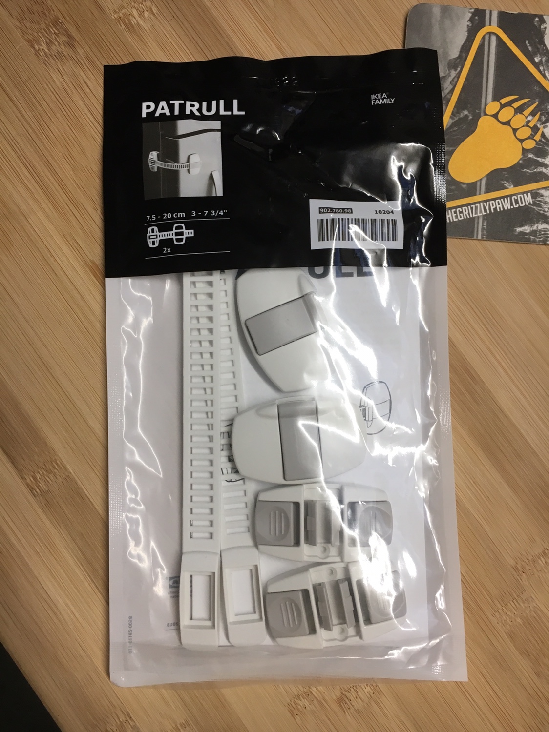

Brilliant can I ask you where you purchased the catches for the front of the drawers thanks in advance.
Also from Ikea, they do work well. I think they may have been discontinued though... I had initially tried the touted magnet closures but on our first spin through a roundabout the cutlery drawer flung open with an almighty crash. (No, I’m not the guy who over takes in the roundabout) So these were sourced enroute as a temporary fix, but we now we kind of like them.
Okay sterling :Stig no seriously they are a really good idea, see what you mean about the drawer flying open round roundabouts. Just had a look on IKEA webpage came up with nothing back to the drawing board :(but thanks anyway.
You could possibly install a lock in the unit side panel so the pin locks into the drawer side. Just need to check the clearance between the unit and the drawer first.
