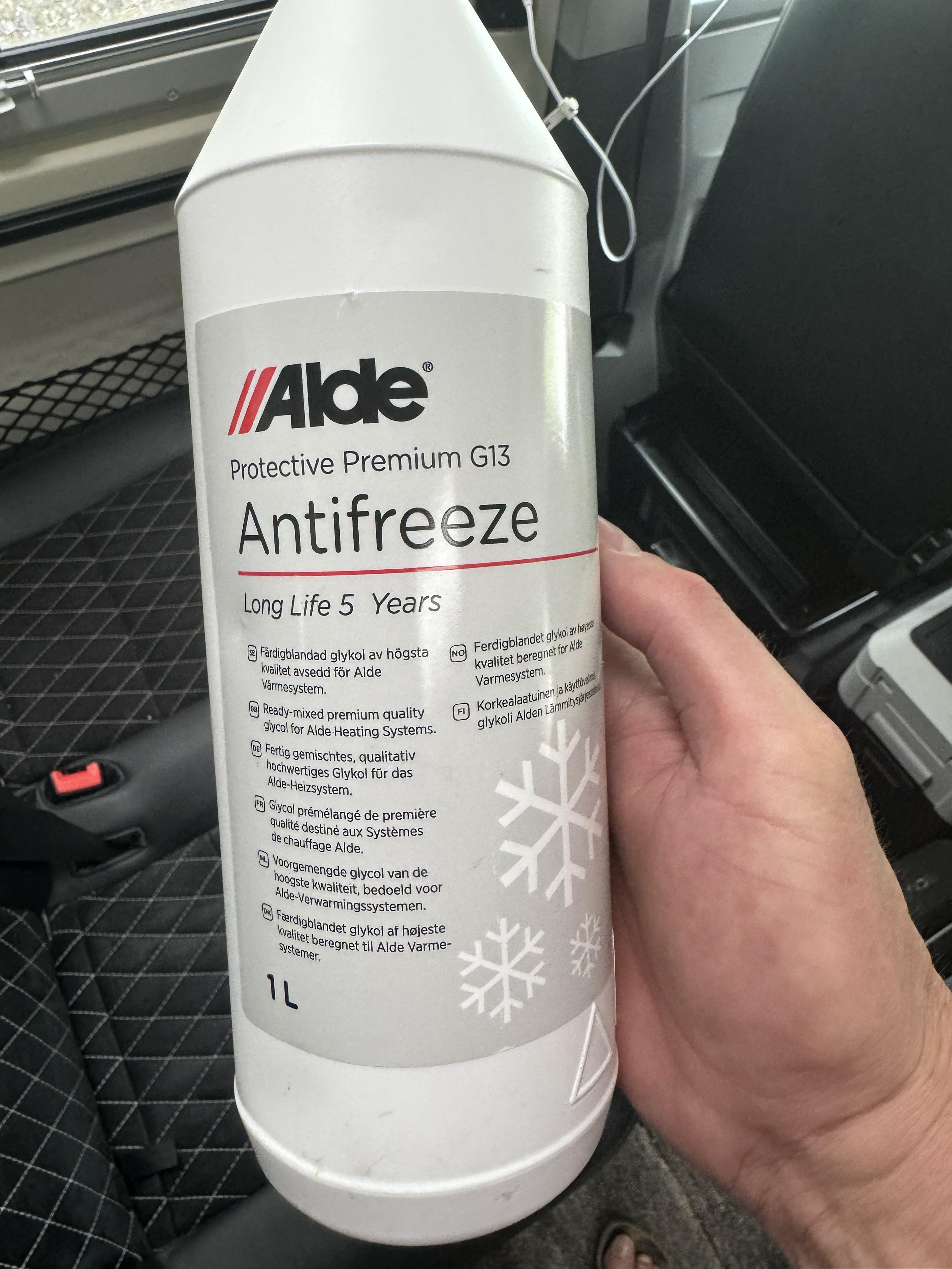

Hello, can you tell me what you use for water heater coolant and at what strength ( water to coolant mix)
many thanks

Sure thing! This product from Alde is excellent. The water boiler, tank and bits are also from Alde on the Joker and assume the Sven.
