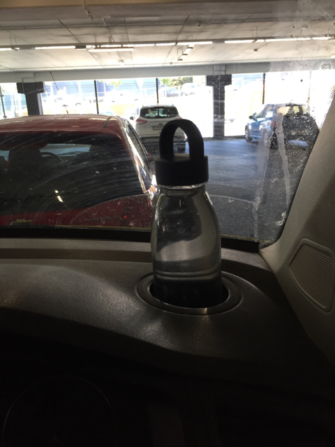

Yes you're right on the personal taste thing.Suppose it’s all a matter of taste. I think it looks good!![]()
Although they look as if they might work, not sure about the cup holders on top of dash, spillage down the heater vent could get smelly.
