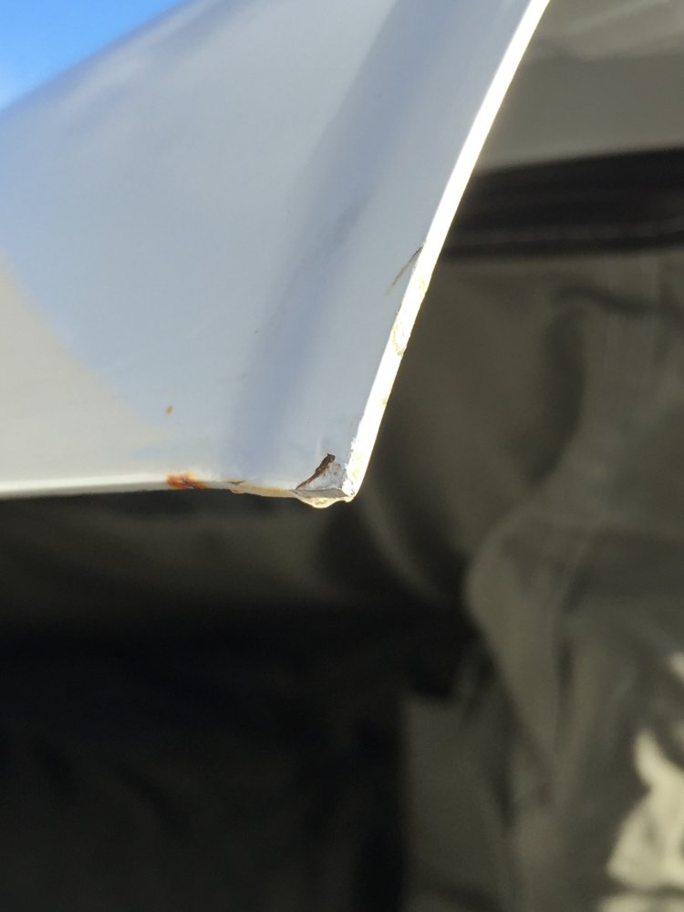

Thanks Trebor. What is image 965 (second image on this post) and where is that on the seal or is it the corner of the aluminium roof? It looks pretty sharp to me, and is that paint peeling?The exposed corroded steel is mainly in the base of the U but some other areas . Very difficult to photograph and probably 20/30 spots in the straight front section . The sides and rear are much better . I have posted some photos in media x4 . Hopefully you will be able to see them .

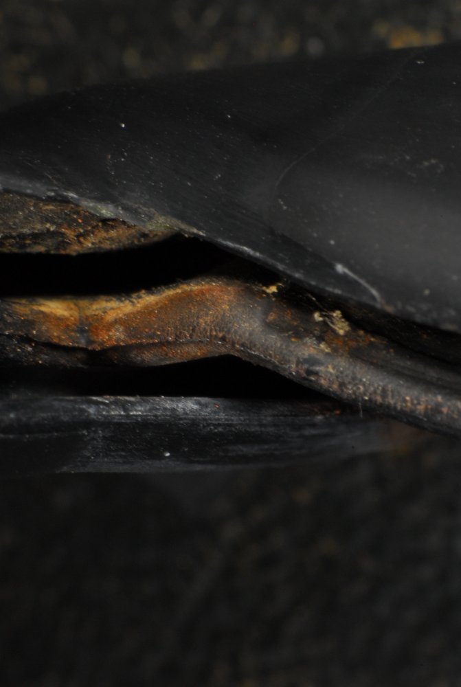

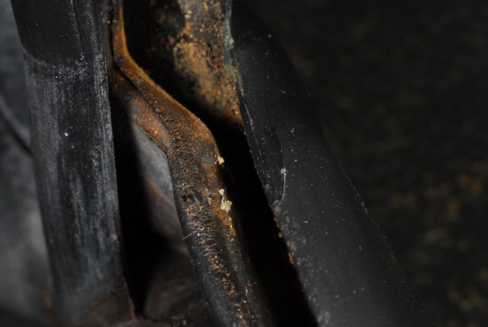

Thanks Trebor, I think I can work out which is which. Very interesting.I have uploaded x4 photos to media hopefully . Old seal ,new seal and roof corrosion . Removing and refitting seal is really easy . Just avoid putting any force on 90 degree weld . Start removing half way down a side .

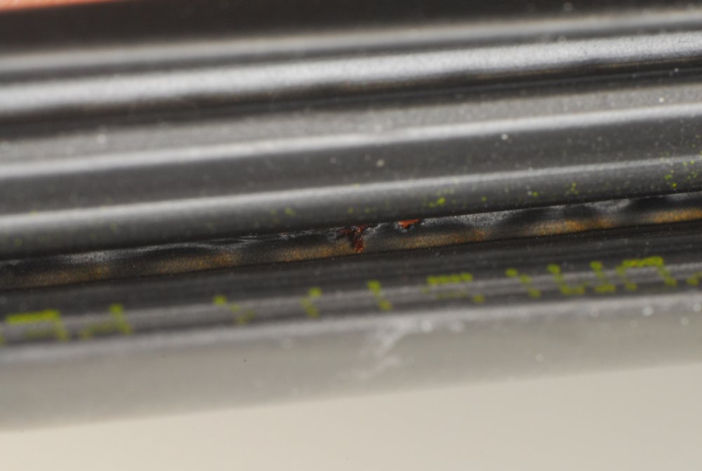

Thank you for taking the time.View attachment 18625 View attachment 18623 View attachment 18619 View attachment 18620 Ok . I've had my second new seal today and just checked it under mag x5 at home before fitting . Sadly as I expected this seal is exactly the same . Visible wire in numerous places in the front straight section of the rubber . This appears to be corroded steel but I'm not entirely sure . It's definitely not aluminium . It's orange almost copper / rust coloured with something that appears to be corrosion . I'll try to take x50 pictures over the weekend . I don't blame my dealer at all . Just had first service today . Excellent service . Clearly there is a big quality control issue here . Naked eye would not pick this up . These are the labels off the latest packaging . I'm off to Merribel in van in next few days and then Dubai ( not in van ! ) so will not be able to follow this up for about a month . Don't know which seal to refit but will have to do it tomorrow with silicone grease
