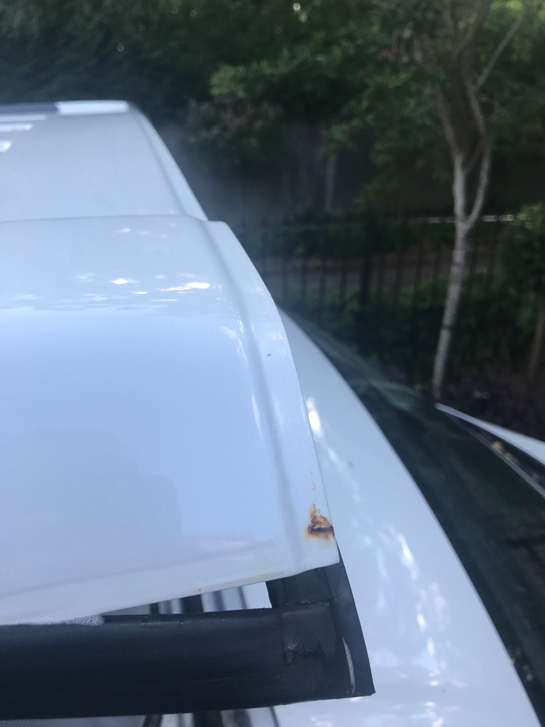

Was cleaning round the rubber seals of by 2 year old Ocean and found the dreaded rust of doom. Booked in for inspection on 18th.

Your T6 appears to be the roof pre tape version? Also the paint bubbling is normally is found the sides and rear of the roof where the water ponds in the seal, your photo suggests to me that something different is happening, surprised to see the rust colour from an aluminium roof.
Is there any sign of exposed metal within the seal at that location?

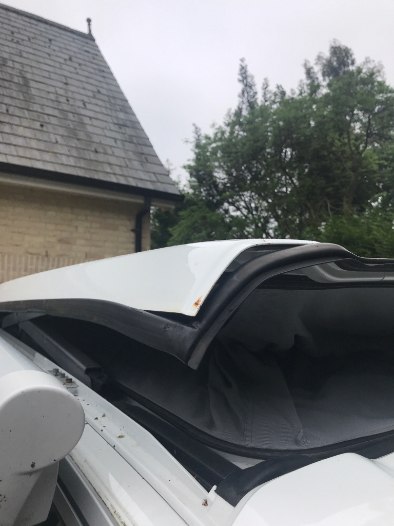

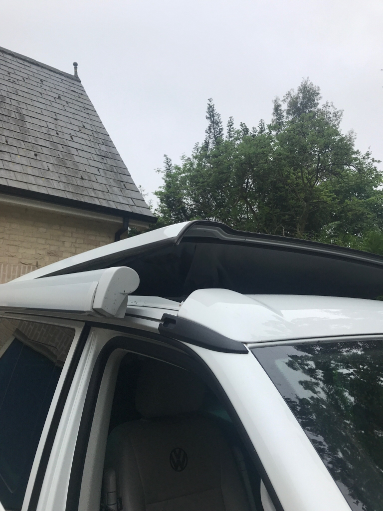

TomC, Can you show other images of the section of roof please.
That is interesting; looks like rust but the roof is aluminium so I wonder if this is a bit of steel contamination under the paint??
Puzzled as it doesn't look like a Cali roof to me.
Can take another picture later but have put the rubber back on. The rest of the paint all the way round the vehicle was perfect with no blistering. Just this one point on very front edge above drivers corner.
Is there any rust inside the rubber. The seals are made with a steel insert inside the rubber. It's been the opinion on the forum for a while that the aluminium corrodes due to contact with bits of steel poking out of the rubber.
Also does the brown residue on the roof clean off? If you take a look at some of the other photos of the corrosion, you'll see that this looks like something else completely.
Tried cleaning it off and it wouldn’t come off. On close inspection it looks like a joint where the rust has formed. Will look inside the rubber also.
looks like a bit of metal swarf has been trapped under the seal. not the usual bubbles from the aluminum corosion, looks to be on top of the paint rather than coming from underneath.
Its possable it was trapped under the seal before the paint was cured.
I would still be looking to VW to fix it and replace the seal.
Take it in to VW for the report and after that try cleanning it with T cut or something similar its possable you may be able to clean the rust marks off the paint.
on the up side the rest of the roof edge is clear but still worth keeping a eye on it.
The roof cannot rust because it's aluminium, it can corrode which will leave a white deposit. Almost certainly it's rust from an exposed part of the metal insert in rubber seal, just needs the rust staining rubbed off the roof and a new rubber seal put on.
I can guarantee it is.
My error, thought it was a front to rear view but now see its a side view in new photos.
Is that a rust stain on the body where the seal closes onto?
looking like a seal problem as others have identified.
